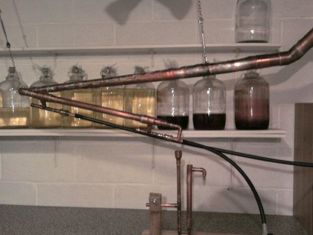

On with todays work...Started off running a strip on a 25lts sugar/kale wash.
With the strip in the background I got started on making the reflux return..easier than I thought it was going to be. Soldering the elbow onto the upright 15mm first...then fitting the elbow onto the 15mm that enters into the 54mm T section. This 15mm will be cut when I know where the return from the PC will fit into it.
The 15mm pipe will be cut when I've sorted out the length of the outer tube....
Update on the photos...
Now that's more like it...
This length of 54mm is 5" so with another on t'other side that will make the PC 14.5" long...should I cut it down to 12"???
The finished length is 10" adding this to a 3' column..fixed to the 3"x2" reducer, then fixed to my short length converter on the T500 lid...from the base of the boiler to the top of the column will be around......7'
Not as high as I thought it maybe at the start..

Slightly confused although that would work.
After the reduction why did you expand back to the bigger tube? The reduction increases vapour speed, so that when it hits the vapour splitting T it splits more effectively.
Re: Start on my new column today.
Thank you Myles I'm not looking at your photos...
yes your correct, I've jumped the gun, the 2nd 54mm reducer is for the PC...I'll correct that tomorrow...thank goodness I only got around to soldering the return.
I couldn't wait until tomorrow I had to correct my mistake..
