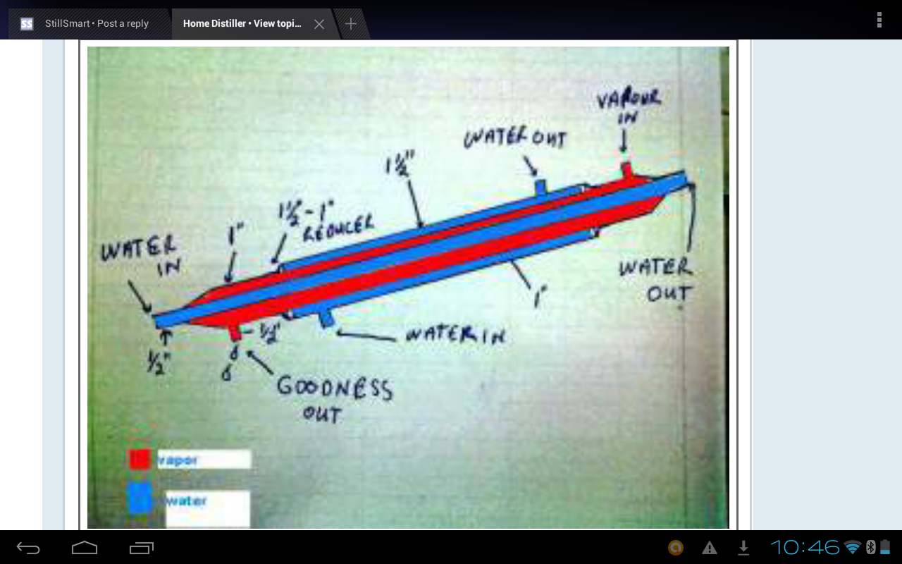

Intrigued by the 3 wall condenser concept, because it would allow for a more compact unit, I got my pencil and paper and set about making some rough drawings to figure out the parts and arrangement of joints.
I was at it for an hour and I can't figure out how to get a water flow into the centre 1/2 inch pipe in the middle of the vapour path and get it out again and a second water flow in the outer 1 inch pipe
Put my out of my misery and post a diagram of the parts and how the flows work, please
Pretty Please!
Pretty Please!
Re: build a better liebig condensor
Hey mate, I tried to upload a picture last night but wouldn't work!. Yeah it did my head in trying to figure out how to work the plumbing too haha . Hope the pictures help.

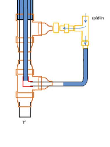

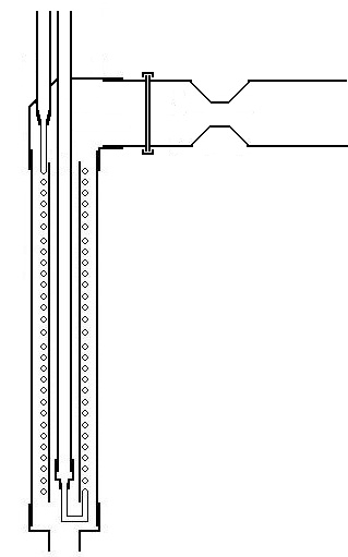

That is an interesting condenser - a coldfinger inside a Liebig. It is a usefull option for a larger bore liebig as an alternative to a turbulator.
I tried it myself (with a coiled outer jacket) but later re-purposed the components, to build the Friedrich's condenser on my pot still.
One possible alternative plumbing option to get the product back onto the axis of the condenser is this:
If you wish you can add in a flow control in the coolant line between the coolant splitter and the input to the central coldfinger, to balance the flow between the 2 coolant paths. The only problem is the extra length, that why I changed to the concentric version.

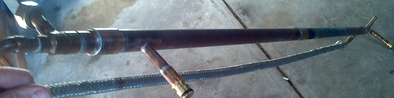

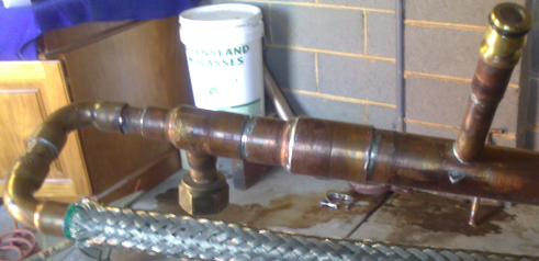

Thanks for the pics and diagrams, it was doing my head in trying to figure it out but I get it now
Hear Hear! And not a drop of solder in sight, very tidy indeed
Thanks Guys - I'll let you know how it performs shortly. You're right though, it sure is fun:0) Cheers, SW
Doesn't matter if you've built your first hand made still or you've done 20 of them, the hole process is exciting!
. No.better.feeling running something you've built with your bare hands!, so satisfying!. I don't think it's been soldered aidan, doesn't look like it?
. No.better.feeling running something you've built with your bare hands!, so satisfying!. I don't think it's been soldered aidan, doesn't look like it?-
Nice rig, should perform well.
700mm should knock it all down, but you might use a bit of coolant and/or water. If its an issue, you can add another 200mm overall length to it, it will become a lot more efficient.
googe spotted it . . . . it hasn't been soldered up yet. Just waiting for the blow torch to arrive in a couple of days. Got slightly ahead of myself and ordered/cut all the pieces and then realised I hadn't got a gas torch :0( Sign of a true plumber!!
Will use lead-free silver solder or brazing rods - not sure yet.
As far as the length and cooling capacity is concerned I only have a 1380w boiler with a home-made power controller, so should be OK at 1ltr/hr flow - that is sufficient for my 2" Boka.
Cheers, SW
