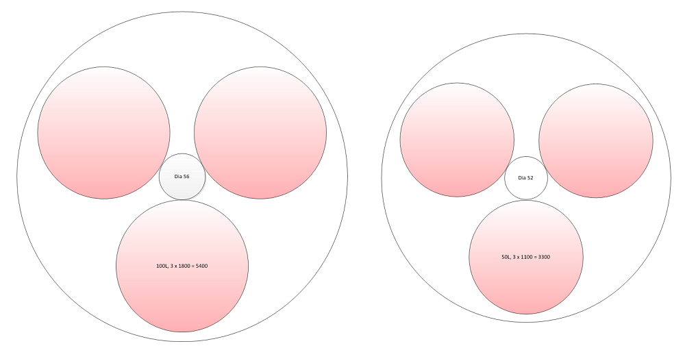

You can either build an electric hob, or mount electric cooker rings directly into the skirt of a keg. With a bit of insulation under the rings this does make an electric keg a much easier (although not quite as efficient) option than the immersion heater version.
You can get the cooker rings new from online stores, or if you are so inclined you can acquire used ones.
For a 100 litre keg you can fit three 7" x 1.8 kW rings for a total of 5.4kW
For the 50 and 30 litre kegs (same size lower chimb) you can fit three 6" x 1.1 kW rings for a total of 3.3 kW.
Add some rockwool insulation and you are good to go. There is even enough space available for a central keg drain.
As I said this is not as energy efficient as the use of an electric immersion heater, but it is a lot easier for the self builder with minimal tooling available.
