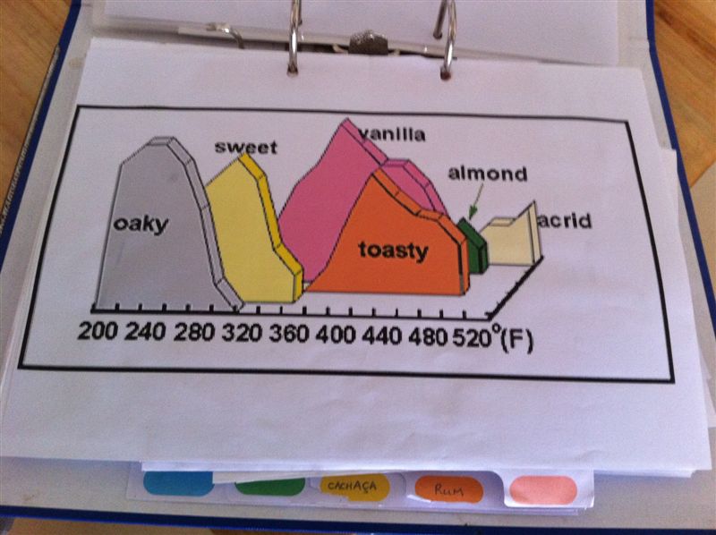

@ Cat5cable: With a greater exposure to end grain, you will shorten the time considerably. I always use a minimum of 3 months before releasing a product, but my oldest that is still ageing is over 6 years.
This chart may help you a bit.

RumJohn wrote:@ Cat5cable: With a greater exposure to end grain, you will shorten the time considerably. I always use a minimum of 3 months before releasing a product, but my oldest that is still ageing is over 6 years.
That chart goes to 500°+ so it's irrelevant RJ. Surely that refers to the toasting of oak, has no relevance to soaking white dog?
Oak ageing does many things, two of which are the bonding of foul compounds (carbon purification) and extraction from oak of ethanol soluble flavours
Any reading of the aging process will show that time and temperature are related in aged maturation.
It takes more time to extract fouls, years, than to add flavours such as oak vanilla and colours, which take months.
So
There are better ways such as cold filtering but otherwise run thru activated carbon for the cleaning (10minutes) and then use temperature plus oak to extract flavours. About a week at 170°
