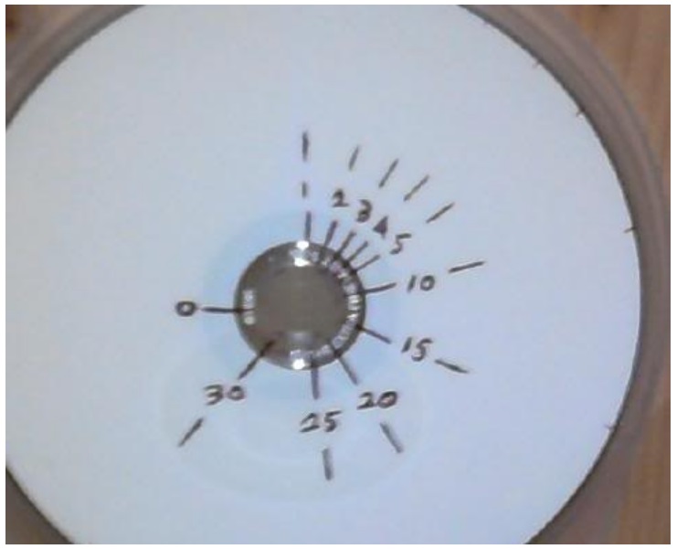

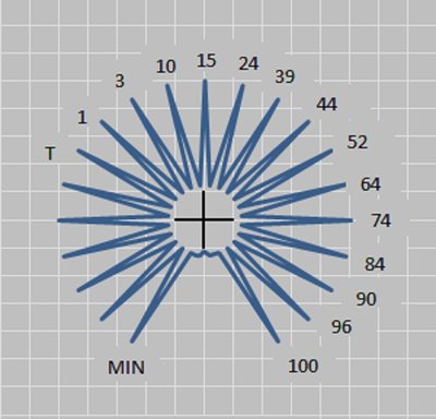

Absolutely right @Mash I am just being fussy. But I also said that the actual power being used is not really that important.
To be honest what is probably of most value is knowing if it is linear or not. For example on an early one of mine I got this result.
There is 90 degrees that does nothing at all but from then on it is reasonable. 0 to 3 kW.

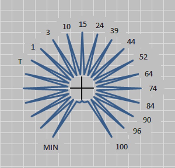

And a different controller in % of max power.
