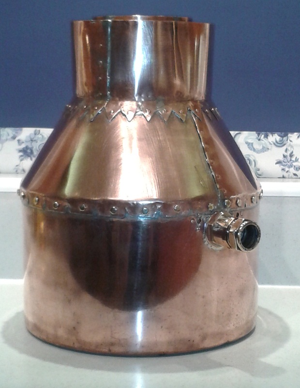

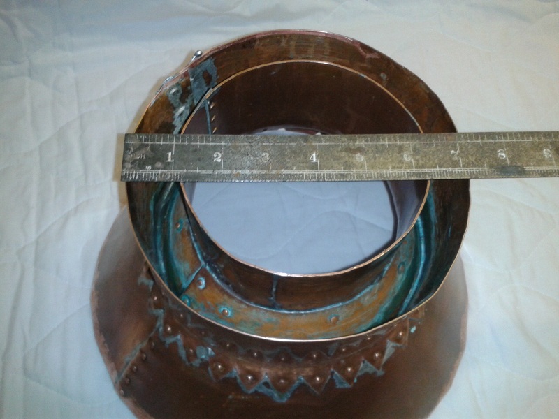

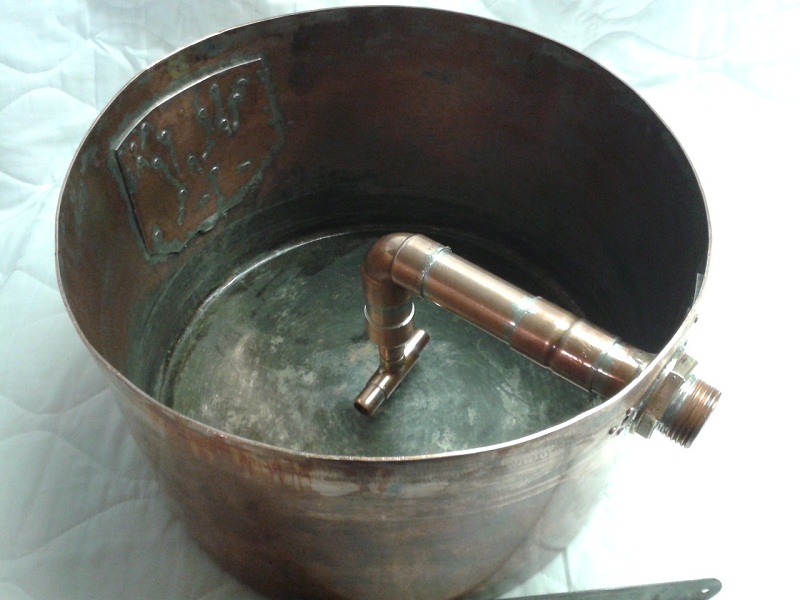

I built a water sealed copper pot still with the intention of using it for gin.
This was intended to be used on a hotplate, total volume 22 litres, but I recently added in a vapour injector so I can use it in a steam / vapour injection mode like a thumper.
I didn't make the pot base, it came with 2 long iron handles that I removed, and is about 2mm thick throughout, I just added the top section.
The water seal is deeper and wider than usual, but I wish to put a botanical basket in the vapour path.
Jenevier is my intention, that's an old style gin that includes some malted grain in the grain bill. Hard botanical's in the boiler, citrus and herbs in the basket.
