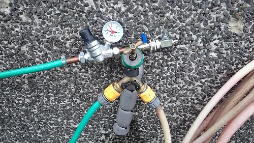

i'm having this very problem as most T 500 users are i would think my problems are :
1, i rent so i can't add it to the existing plumbing
2, my system needs a PRV valve pressure here is massive
3, the water temp is very low here so to get a reasonable flow rate i have to run a little hotter. So maybe the Temp isn't so important in this case more the flow rate.
The good thing is i have an outside garden tap which i am going to make a small hose pipe from that jubilee clip it to copper pipe which would have the PRV in, then a washing machine fitting connecting to the 20mm Tap adaptor and then the needle valve to control flow rate. Once i get this all sorted i will post pic's may help someone else. At the moment i waiting for the PRV from ebay
Jag
Jag

Re: Cooling water control
Just in case anyone hasn't located PRV here's a link to a well priced one at Screwfix
http://www.screwfix.com/p/prv-with-gaug ... 22mm/41943
here is my fix for my problem will run my still tonight see how it works and report back. Hopefully it will fix my water pressure problems
