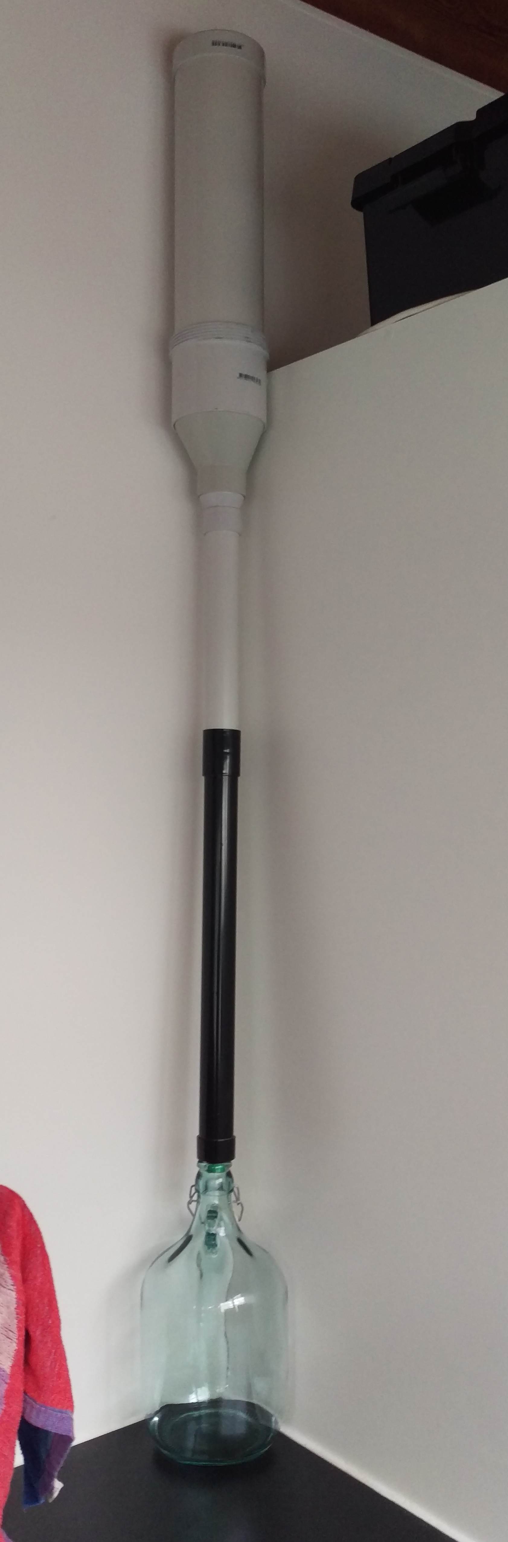

I thought I'd just share my home made filter for use with Active Carbon.
I know there will be some discussions around health concerns for use of PVC for this as the Alc can absorb chemicals from it but instead of firstly spending $$$ on a stainless version.
The total cost for this to me was $25 excluding the single use stuff (carbon, filterpad)
It clears 5 ltrs at a time and the carbon is good for a 25 ltr wash. The black section at the bottom is detachable from the upper section for 2 reasons 1: storage as assembled it stands at 4-5 foot and 2: so I can fill with active carbon Powder form.
The cup at the end of the black is also removable, so I can place a makeup pad and stop cabon blocking my drip nozzle which is an adjustable water dripper.
Happy to discuss more should you like. Just thought I'd share.

This seems an expensive way of doing the thing, to me, and so I invite others to come back with a better way of filtering spirits cheaply.
At some time we must all have dreamed up what seemed the best low cost filtering method, and I think that there have been a few posts here long those lines.
Welcome bongo, don't be afraid of posting anything here, or putting a post in the right/wrong place, if you do it will be moved, no problems.
Please read around this site, there really are better ways of doing this, but it is your choice to make.
Wishing you well.

bongo wrote:Morning All
You admit that you could be harming yourself and your friends but you are not bothered because you are doing it cheaply
- remind me not to have a drink at your house.As far as I am concerned the same applies to an Essencia unit.
Carbon filters are easy to build using glass / stainless / copper / cork and you can make them a lot cheaper than 25 dollars.

Bongo what are you using it for?
You mention that the carbon is good for a 25 litre wash. Are you putting fermented wash through it or distilled product?
I do need to say that I haven't used a carbon filter for many years. You really don't need to.
I would be concerned about the plastic also. If you are filtering correctly (very, very slowly) then if you are putting distilled product through it, then it should be in there a long time.
Remember flow rate should be no more than 1/4 of the liquid holding capacity of the carbon bed per hour, if you are using it for purification purposes.
If your carbon filled tube can hold 1 litre of liquid - in addition to the carbon - that litre should take 4 hours to flow through the filter bed.

OK folks I haven't seen this on here and don't know if it is still available or not, so I will put it up.
If you are going to filter with activated carbon then I do recommend that you follow the techniques mentioned to get the best out of your carbon.

Miles wrote "I honestly believe that the carbon filtration system was first introduced to the home distillation scene by the same folks that introduced some awful design stills which were so bad you were obliged to carbon filter."
Having faffed around with carbon filtering and recycling carbon I agree with you Miles. If you don't put it in you don't need to take it out.
Pushing the wash % too high (I try to keep mine round 8%)
Digging deep on the strip run and then putting it all into the spirit run
Keeping too much outside of the hearts cut in the final jar
All lead to off flavours

YHB wrote:Myles - That PDF has been posted here several times, and every time I see it, I tell people not to follow that guys example of how to make a plastic funnel.
I absolutely agree with that. My intention was nothing more than to draw attention to the section dealing with the soaking and use of the carbon itself. Pages 22 to 27.
Not the equipment the carbon was put into. I should have made that clear.

Well I've been using some of that guidance for years, successfully.
I didn't need to use the instructions for building, because I bought my Z filter unit some time before finding Gerts ebook.
The connecting pipes on the Z filter are alcohol resistant apparently, and the filter/carbon holder section are HDPE.
The scare from some time back, was about using kit made from polycarbonate, which used to use a plasticiser called Bis-Phenol A in the production. These days polycarbonate is usually BPA free and the materials that have been found to be alcohol resistant for short periods (though I don't know what the definition of a "short period" would be) is HDPE/high density polyethylene and PET/polyethylene teraphthelate.
Don't know what the difference is, other than PET is usually clear/glass-like in appearance (and used in pop/soda bottles, better bottle fermenters, etc) and HDPE is translucent and used in fermenter buckets, 5 gallon cans and even 1000 litre IBC's.
I'd guess that the short period thing is more about the alcohol being an efficient solvent that might start to break down the plastics after a while - but as above and I don't keep my spirit in plastic long enough to have to worry. I get it down to drinking strength then carbon filter it straight into glass for storage........
