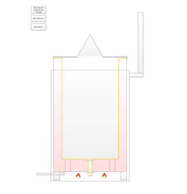

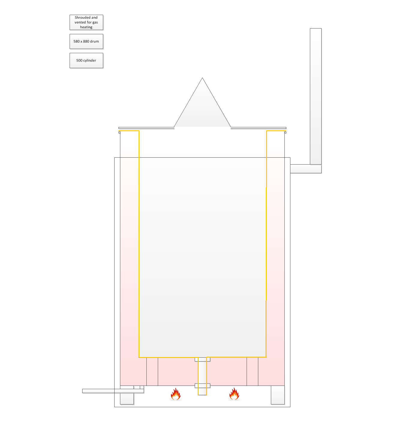

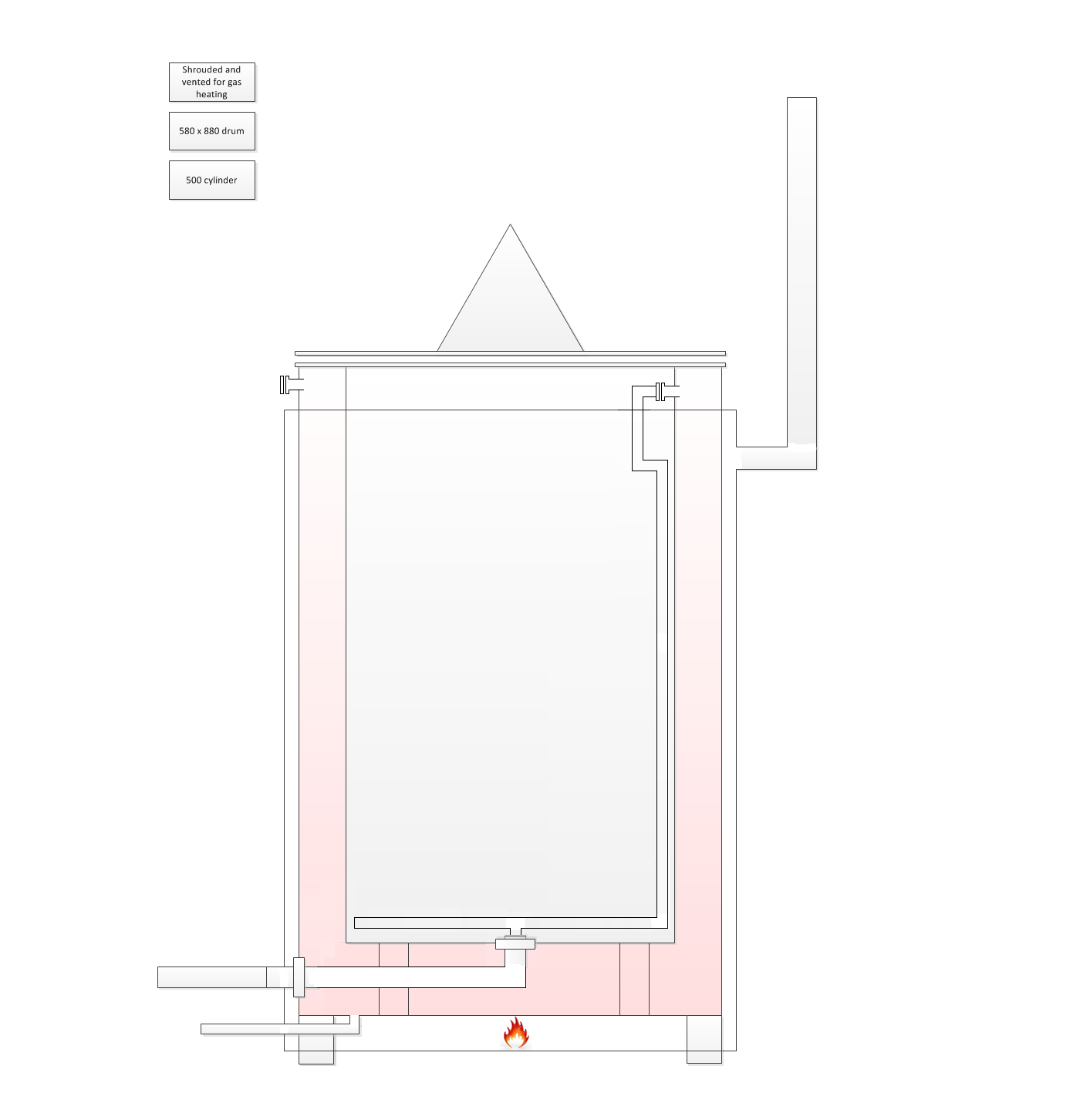

Simplified drawing.
Am going to use a paella burner so the drain can go through the centre for ease of construction. that way the gas jets will be a little bit further away from the connector securing the drain into the stainless drum.
The flange on the copper liner is just trapped between the drum and the drum lid, and secured by the drum clamp.
Fitting the copper liner into the drum is easier if the drain is in the centre. I will fit a compression bulkhead connector into the stainless drum and fit the compression ring and nut onto the drain tube after the liner has been clamped in place.
