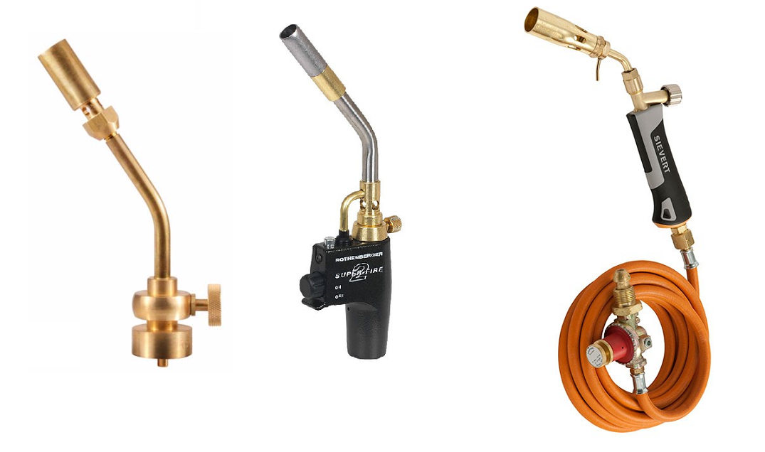

I still use my handheld torches even though I have the bigger Sievert hose fed torches.
I started with a couple of simple brass ones from B&Q that screw onto gas bottles. One fine tip and one general one. Then I added a Rothenberger that was on MAP gas (when it was real MAP gas)
And of course I have the Sievert. Which one I use just depends on how big the work piece is. I have brazed 54 mm fittings with 2 hand held torches but it was difficult.
Brazing 35 mm and below is a piece of cake with the hand held torches, as is soldering up to 54 mm. Its only when I start brazing above 54 mm that the Sievert comes into use.
The advantage of the Rothenberger style is the built in gas regulator that you don't have on the simple brass torches.
There are even cheaper gas torches available but some of them are of more use in the kitchen than the workshop.
Just bear in mind that each one works over a certain range of joint sizes and that the issue is not flame temperature but simple quantity of heat produced. Big joints need more heat of the same temperature than small joints.
