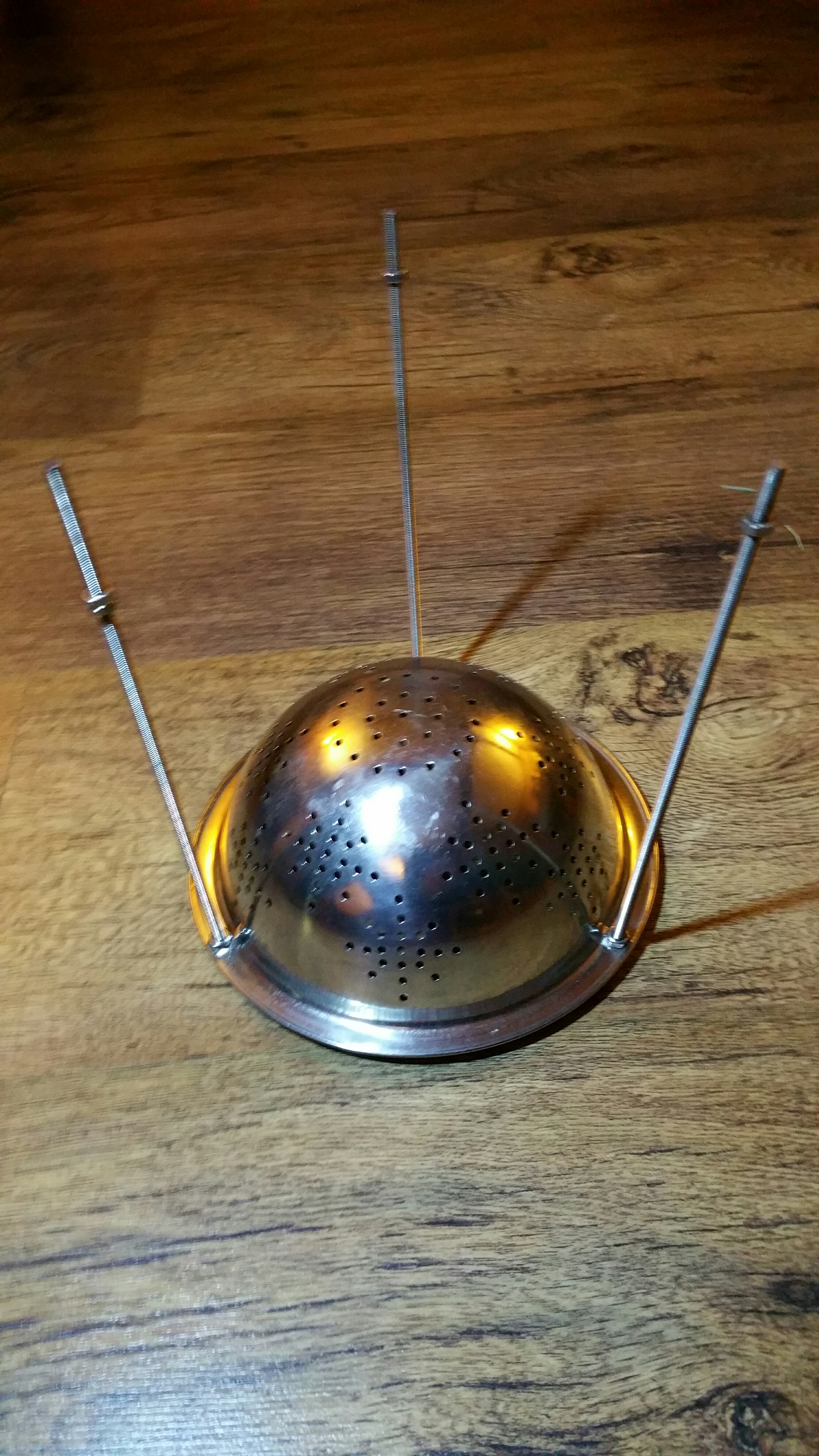

@Chill does it now? Interesting - I have several heads runs stacked up - now I have an excuse to get on with them!
It had occurred to me to collect in 100ml batches, and I will, but last night excitement and enthusiasm rather got in the way of scientific rigour!
One thing I am going to do is source some stainless rods and fittings - seen some on Amazon - all I could get was zinc-plated mild steel and while I don't imagine much will happen as a result of alcohol exposure, I'd rather be safe than sorry.
My colander came from Sainsburys as one of a set of two for £6. Bashed the handles with a hammer to crack the spot welds, three holes six acorn and three flat nuts = job done. Looking forward to more sputnik missions in the next few days

I have these as antennae ☺
http://pages.ebay.com/link/?nav=item.vi ... 54&alt=web
Same guy does nuts separately.

Thats not a sputnik - you have a docking port
... or am I just jealous ?

Mash wrote:Thats not a sputnik - you have a docking port![]()
You have outie antennae, and I have innie antennae! I can't imagine it makes much difference

Just realism I suppose.
Seriously I have by pure fluke got a sputty that fits perfectly in the bottom on the fan housing and adjusted the legs according.
Apple schnapps tomorrow... Guess the recipe!

Getting ahead of myself I know, but with the sputnik would an 10cm stainless steel mesh skimmer (like a shallow sieve) be any good? Does the mesh allow more to get at the botanicals than holes in a colander? or does it make no difference?
Also the smaller size would probably mean you could process 3ltrs at a time as it is much shallower. Is my thinking flawed?

I don't think that is quite big enough.
I reckon you could use a colander, or a seive.
When you look at the underside of the fan unit, there is a lip inside. You need to be 165 mm. This will get the basket as high as possible and give a reasonably good seal.
If its about 180mm you will to be a little bit lower down. That is pretty much the inner diameter of the boiler.
...in old money that 6.5 inches or 7 further down.
I have 2mm holes - just enough for the stuff to stay in after crushing without to much falling through.
