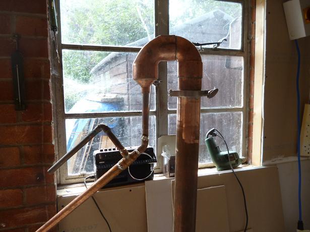

this is the boka head and condenser section, also in this pic is a now redundant centering ring section
and the coil/cold finger prior to soldering
yes it ended up almost as dirty as the bot head solder job.. both are now a lot cleaner after a long filling session.. one day i may sus this soldering malarky, bit not anyday soon, i tend to panic when the metal gets hot dunno why..
the idea being i can opt to run either flavour runs or chase a-zero, and run easy stripping runs in advance of both..
the column attaches to the t500 boiler with a SS triclamp flange screwed onto the t500 column nut. its not a great seal and needs a bit of flour paste in the lid depression to seal.

Finally soldered the condenser (badly a few blobs still to clean off..)
on looking at it the water out tube could have pointed down or to the side

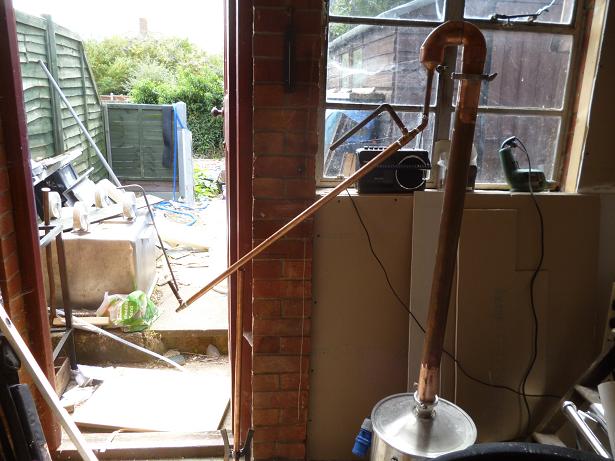

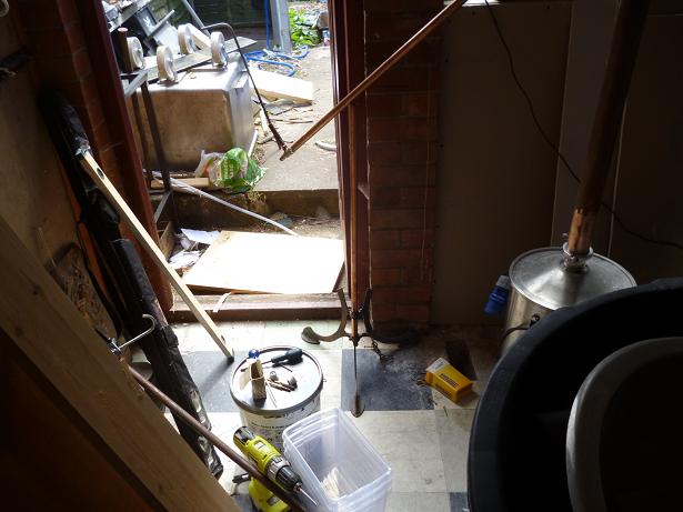

getting there.. excuse the bad photography and messy brewshed, im in the process of 2 or 3 jobs at the moment..
i still need to complete the stand to support the condenser, but will probably run vinegar through while i sort that out ....
