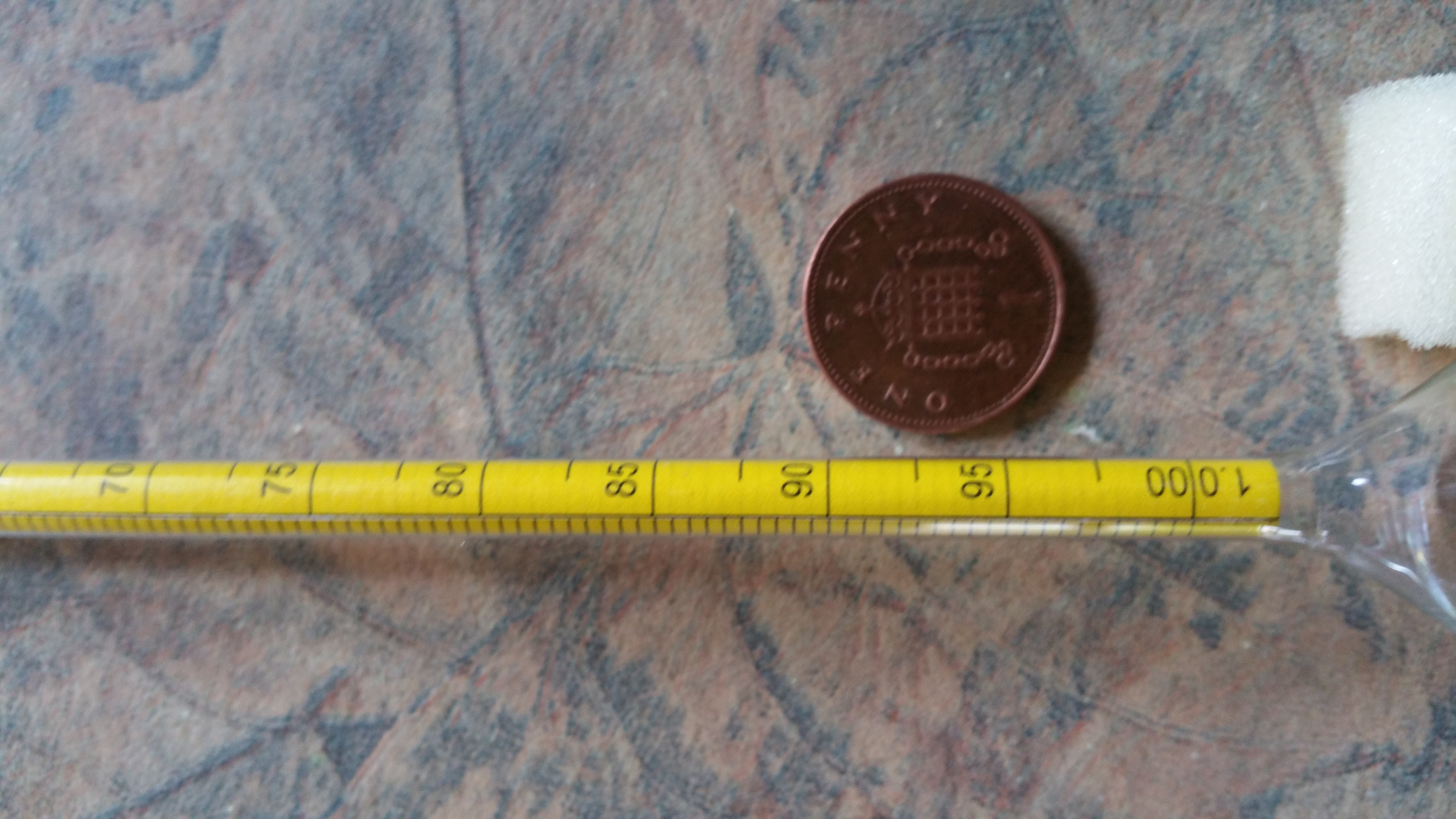

Thanks for the reply all. Just put some in a tube to test gravity and it stopped right in and went off the sale, lowest reading on it was .995 and its floating at about .990. So should be good yes????? Also tested strength and its so difficult to read as the lines are so close together but its between 15-20%.
What do you all use to measure abv, I've seen people post on here things like its 13.5%, how can you read that accurate??.
Thanks for all you replies, feeling more confident noe

Wow that's a high abv wash! What was your original gravity Paul? I use a hydrometer, spirit hydrometers can come in a shorter range which makes them more accurate hence some people giving a half degree measure. Different ones have different ranges, it all depends how good your eyesight is I guess! Some people are very clever / fortunate & have digital parrots which can give a 0.1 degree accuracy.
.990 is almost certainly done mate yes, get it in there!
Re: wash not cleared
paulf wrote:... Also tested strength and its so difficult to read as the lines are so close together but its between 15-20%.
What are you testing on... A hydrometer?
Temperature, clarity of the brew and the fact the digits are really close, will make this inaccurate. Don't worry but treat it as a guide not a definitive statement.
There are more accurate hydrometers.
You can also use refractometers which are easier to use and less easily broken.

paulf wrote:What do you all use to measure abv, I've seen people post on here things like its 13.5%, how can you read that accurate??.
You can't read abv of a wash with a hydrometer, it has to be calculated.
And you can't read abv of a wash with a spirit hydrometer because any residual sugar in that wash will give you a wildly inaccurate reading.
With a conventional hydrometer you need to measure the Original Gravity or OG of your wash and then the Final Gravity or FG when you think fermentation has finished.
With 6kg of sugar in 24 litres of wash my OG is usually 1.090 and using Vodka Star yeast I expect it to finish around 0.984
Get rid of the decimal points and subtract the FG from the OG
1090 - 984 = 106
Divide that by 7.36
106 ÷ 7.36 = 14.4% abv
Or search for an online calculator, enter your numbers and hit the ‘go’ button.

Thanks for that I was just reading about the calcs actually, I have used them before when making beer but forgot to take sg before fermenting and was trying to use spirit hydrometer to get abv but struggled, one minute it looked about 13%, then it looked more like 20%. Makes sense now about it not working very well until its put through the still. I've just got my second wash Started and made a note of sg (1.095) so hopefully will remember to do that in future. Thank you
