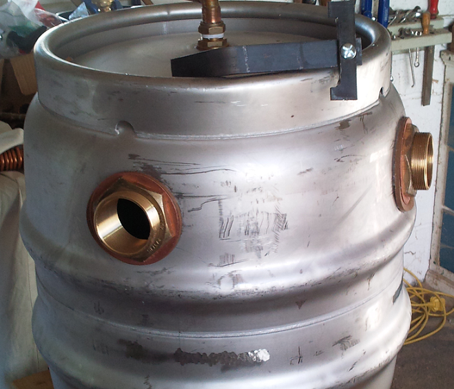

Postby Myles » Thu Feb 12, 2015 8:15 pm
Ok a word of caution here. 2.25" bsp essex flanges are a big bit of kit. I used them on my own keg but it is a 100 litre keg. Same height as a 50 but quite a bit wider.
I had to mount them a bit higher than I would have liked because of the curve in the keg wall. They are brilliant though, I used a 4 foot sash cramp as a spanner with a home made tool to get them tight.

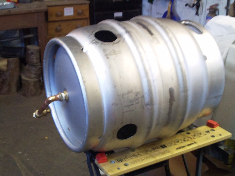

Postby Admiral Toad » Wed Feb 18, 2015 10:28 am
Have now acquired 2 1/4 inch weld in flange for the element and now ordered a 6 inch weld in tri-clamp flange for the column to help with cleaning
next question is what do you recommend for cutting out these large diameter apertures? Perhaps a plasma cutter?

Re: Beer keg to boiler
Postby Mash » Wed Feb 18, 2015 1:34 pm
Plasma cutter - my the force be with you!
Nah - hole saws - brilliant, nice tidy hole and cheapish.

Postby Easydrinker » Wed Feb 18, 2015 5:43 pm
That is going to be quite chunky stainless you'll be cutting through,I am unsure a cheap holesaw will do it,but hey,I have never tried.
I would guess that a slow speed,and a plasticine(or something similar) type material used to construct a 'well',to hold cutting fluid will be needed,as in my experience of cutting thin SS,it hardens with heat.
Assuming that you are farming out the weld work,get them to cut the holes?

Postby Capt-Cudellez » Thu Feb 19, 2015 8:54 pm
I've cut stainless with a hole saw before but used a cobalt carbide one, the type with 2 or 3 teeth rather than the HSS ones with teeth all the way round.
Plasma cutter is a great bit of kit if you can get someone with one. My keg boiler was cut with one, but we forgot to put a little water in it during the cut, so the inside is splattered a little. I'm sure that's the reason if took quite a few washes being run through it before the output stopped tasting like burn shit.

Postby Anavrin » Thu Feb 19, 2015 11:51 pm
Just a quick thought on this if you have a top opening big enough to get the inner part of this tool inside, you could use a Q-Max cutter to make perfect holes for your elements, of course it depends how thick th wall of the keg is but here's a link anyway if anyone interested.
