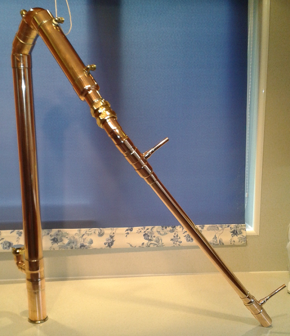

At more than 3 kW I switch to a shotgun condenser for convenience.
I also rarely bother with a single liebig these days as I favour the use of a shorter (but more complicated to build) concentric condenser with 2 vapour paths in the same shell.
You can easily cut the length of a 3 kW liebig condenser down to 26" instead of 62"

Re: Pot head
Postby inspector gadget » Thu Oct 13, 2016 7:59 am
Thanks for that..
is there a drawing for that? I get the idea but my head says no...
