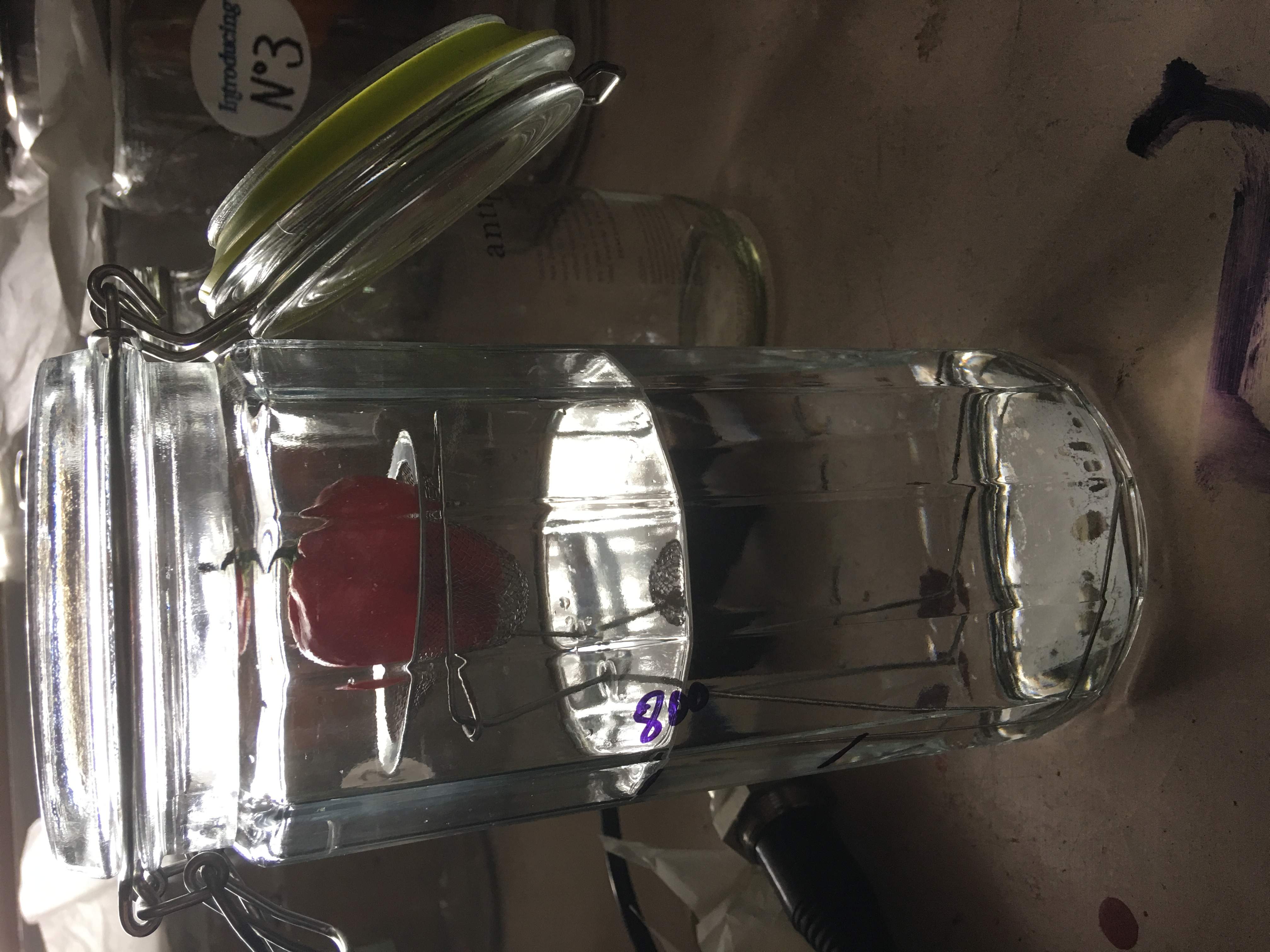

Postby Mr Four Square » Sat Jan 14, 2017 6:21 am
I haven't had any luck getting hold of Ghost Chillies so far this season so for now this Habenero will have to do. About 1 million scoville units for a Ghost Chilli versus 100,000 SU for a Habenero so let's see how this works out.
I'll keep you posted ...

Postby Phantom » Sat Jan 14, 2017 6:33 am
Not sure how much capsaicin will be absorbed like that. The skin being waxy and from the look the chilli being whole.
I chop mine up i.e. chop the green bit off the top, then roughly chop the rest carefully as I don't want any bitterness from damaged seeds, then the lot goes into vodka.
Most of the capsaicin is in the umbilical tissue, so the vodka needs to get to it to dissolve it out the veg tissue......
Re: Chilli Vodka
Postby Pyro » Sat Jan 14, 2017 7:49 am
I have only did Chilli once.
I used one of my home grown Apache's, removed the green bits, opened up and removed the seeds and white bits. then chopped it up and added the vodka.
Not overly powerful but still had a kick and a bit of flavour.
