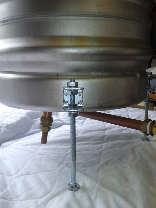

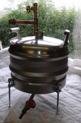

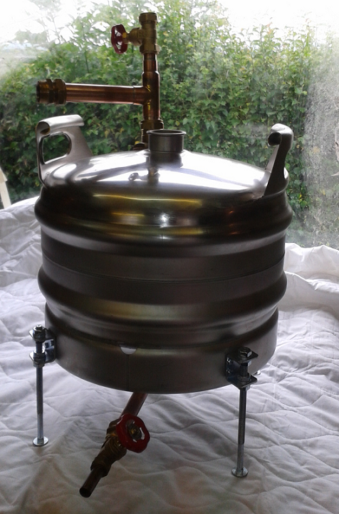

I am building a rig for someone here and it includes a 30 litre thumper that will go under a packed column for Vodka production. It will be fed from a 100 litre boiler.
Anyhow thought you might like to see the thumper. These kegs could be used to build a nice small electric boiler - you just need to build your own element - but that is actually easy enough.

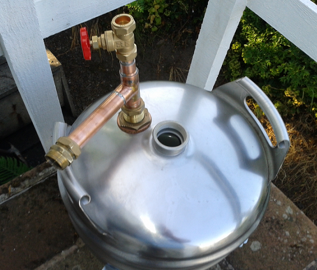

Top mounted vapour inlet combined with the refil valve.

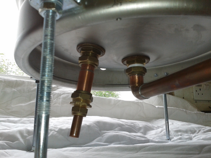

Central drain and overflow ports
And the adjustable legs
This lot is actually going with the pot still I put up earlier as a combined setup that is a pot still and a vodka column integrated together for ease of use.
