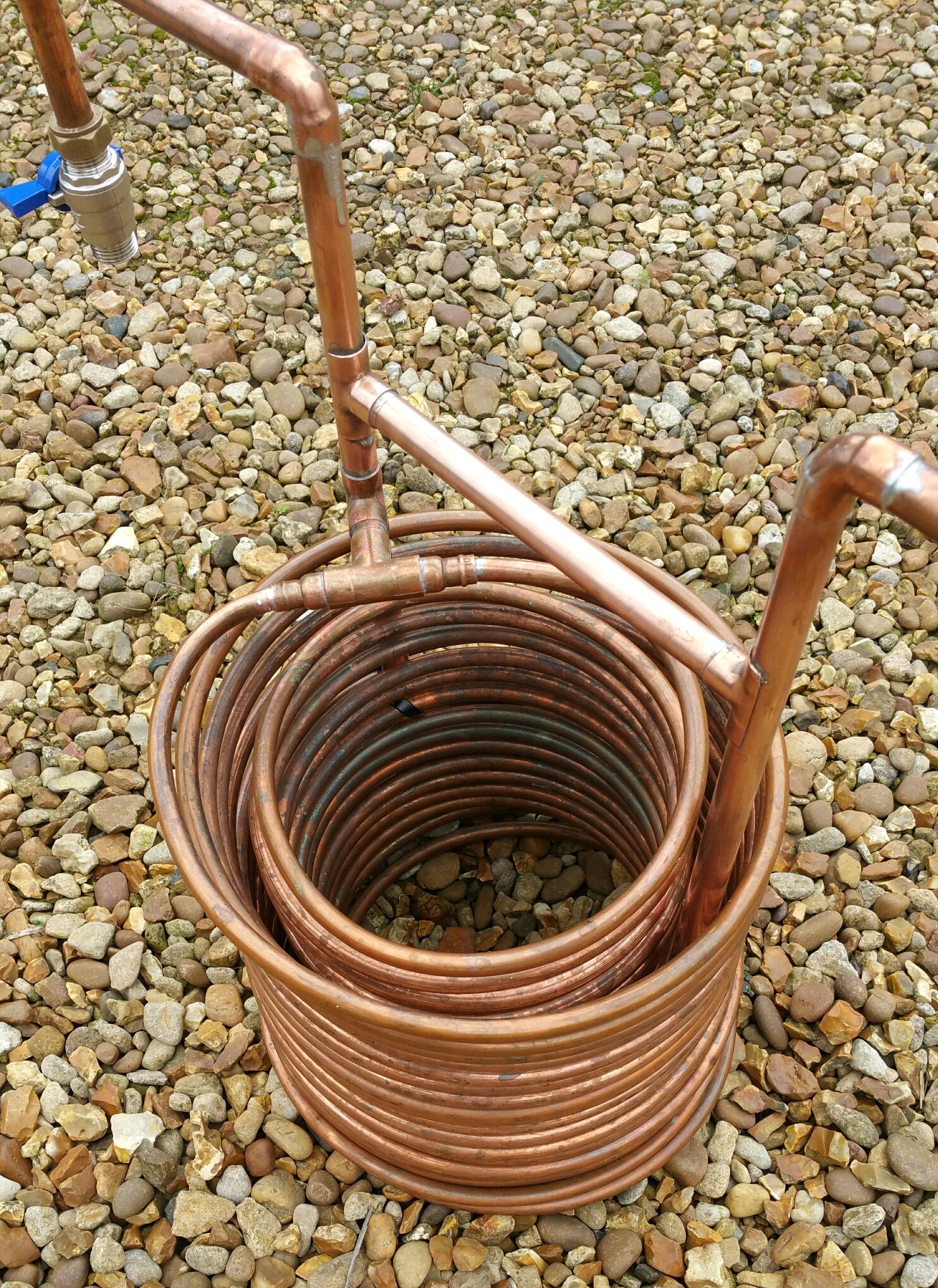

I am building a new wash/wort immersion chiller. In condensers we get the most efficiency from putting the cold 'in' at the point where the product is coolest.
Does it matter with wort chillers if the cold goes in at the top or the bottom? I am aiming for the bottom at the moment but wondered if it really matters at all?

Bring the cold water in at the top, that way the cooler wort will drop causing a convection flow. If you bring it in at the bottom the cooler wort will remain at the bottom.

Mine will seem very similar. I opted for twin coil, mainly 'cos I had some 10mm and many of the retail one seem a bit poor.

All done.
Great fun soldering it up. I had forgotten how nice working with copper pipe is. 8)
Today is wash / test run day in some boiling water. Is it worth adding a good dollop of vinegar?

Proper chuffed 30l 99c -> 20c in just 6 maybe 7 mins. Got excited and forgot to stop the timer straight away. :)

All done, trials and mods finished, so its picture time :)

Well done that man.. ;) the double coil chillers work well.
