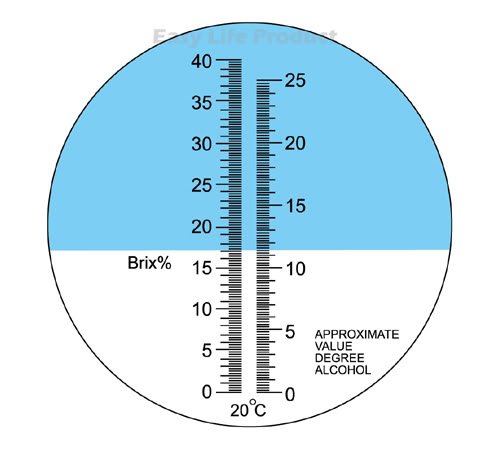

Get a refractometer - it soooooooo much easier.
£15 on Ebay.
