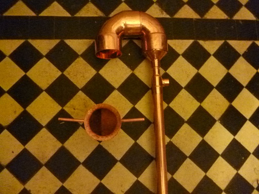

for stripping and flavor runs i have a simple pot head made from 2 x 90 degree end feed elbows and a 54 to 15mm reducer, to adjoin to the column i hand bent out a flange to circa 64mm with a pair of mole grips and bashed it with a toffee/jewelers hammer on a small shoe last.
and after a lot of faffing about i soldered on at a 45degree downward slope a 1m long leibig condenser with a central tube of 15mm copper in a 22mm copper jacket..

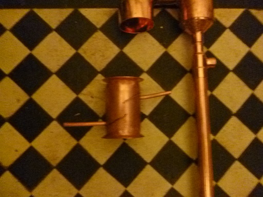

for spirit runs i made 2 further clamp on sections with further hand bent flanges for fitting, a boka collection section and a condenser section.
the boka collection section is not the neatest job, and the 6.4mm od copper tube used for the drain is i think in retrospect a little constricting.
the output condenser for the boka head is a simple tube of 15mm copper terminated with 90 degree elbows i drilled through each elbow with a 10mm bit and slotted a length of 10mm x 500mm x 0.2mm Stainless steel, which is attached to the 1/4" SS needle valve controlling the output flow with stainless steel cone union and compression fitting.

bits assembled before soldering - a few months back..
and after soldering and cleaning
