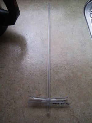

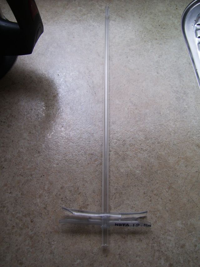

Thanks for that - I think you may be right. Stirred it up some when I took a liter out to check the SG.
I've seen that degasser and have made a poor man's version of my own - will sterilize it and give it a whirl. Here's a pic.
