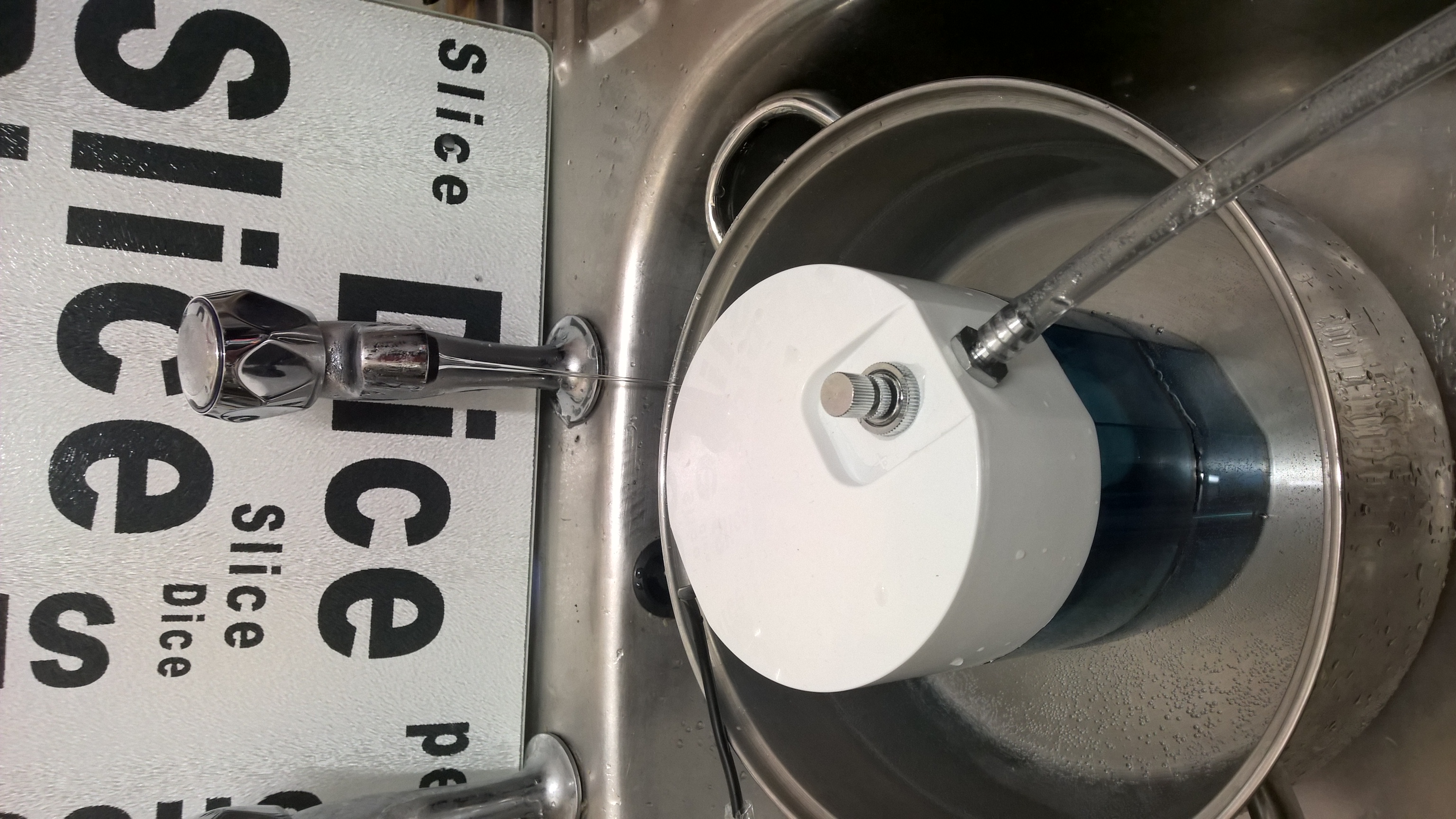

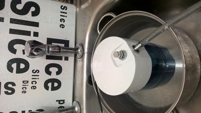

Postby Seagull » Sun Mar 13, 2016 2:05 pm
My beloved water flow regulator at work. No more tap connection problems!
I love those guys at Still Spirits!
Re: new water regulator from still spirits
Postby Anavrin » Sun Mar 13, 2016 4:29 pm
Is that an official Still Spirits bit of kit?
Postby Seagull » Sun Mar 13, 2016 5:04 pm
Yeah it is. Couldn't get it over here so had to order from abroad. Got the first one sent over from NZ, then loved it so much got a back up sent from Oz cos let the first one run dry by accident for a bit
