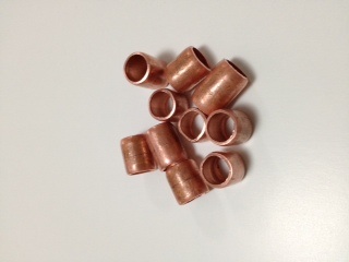

Thanks for the info. I can't confirm the ABV at this time because I don't have an alcometer, but I am working on it. Should have one by next month.
You may be interested in the new anti bump that I plan to use. See photo if it gets attached.
