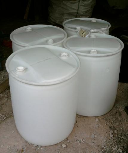

I mostly use 160 litre HDPE drums but I have some nice 120 litre screw top drums. Just bought some 45 litre screw top drums.
I like the screw top drums for fermenters because they are strong, have full size openings, and you can just loosely screw on the lids for fermentation.

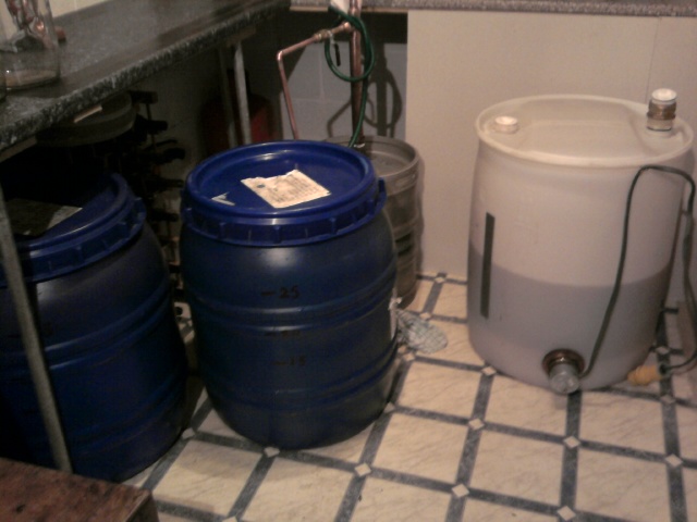

I use a range of food grade drums.
160 litre coke syrup concentrate drums
Plus these 120s
Stills are made with either 100 litre keg boilers or made copper boilers.
Will soon have a strip boiler tha is made from 2 stainless drums. 115 litre inner inside 205 litre.
Plus these 120s

Yes they are the ones. Food grade. I like the full opening. If you take the rubber seal out of the lid you don't need an air lock.
