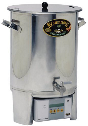

I would like to build a lid with a tri-clamp to attach other things to the top of my 20l Braumeister.
The top of the BM is rolled stainless steel but flat. The issue I have is how to clamp something to it? I thought that perhaps a heavy flat lid, with edges that drop over the side a little and contain a silicone seal. With two 'over center' latches either side to connect it the BM handles?
I know a chap to is a tig welder but I would rather not weld to the BM.
Thoughts please?

Thanks for the link to the fitting - that will come in very useful.
I need to work out how to make a lid/base for the column.
The one in the picture is what it comes with and I need to retain that.
The bigger question is do I need to clamp the lid on and if so - how?
