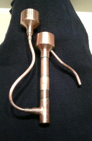

Found this on eBay. Is it suitable for use with the T500?
I'm guessing that you let the distillate drip into it, filling up the tube. Do you leave the alcometer permanently in the tube to constantly measure and have a kilner jar to collect the output?
Is this worth having?
Thanks.
http://www.ebay.co.uk/itm/Handmade-Copp ... SwBLlVZs1Y

It could be used with pretty much anything that drips into a collecting vessel, it just drips into the parrot first then into the jar. If you have any soldering skills at all you could make that for about £10 though! Have a little search round on here, I'm sure someone had bumped a thread with a full equipment list & construction diagram the other day.

Postby YHB » Tue Mar 22, 2016 9:11 pm
Just made from pipe & a jam jar, no fittings. The large cups are from 22mm pipe - split, flattened and knocked into shape with a hammer.
Materials were all from the scrap bin, but less than £5.00 if you bought them.

Postby hampk » Tue Mar 22, 2016 10:17 pm
YHB wrote:Image
That is a thing of beauty..

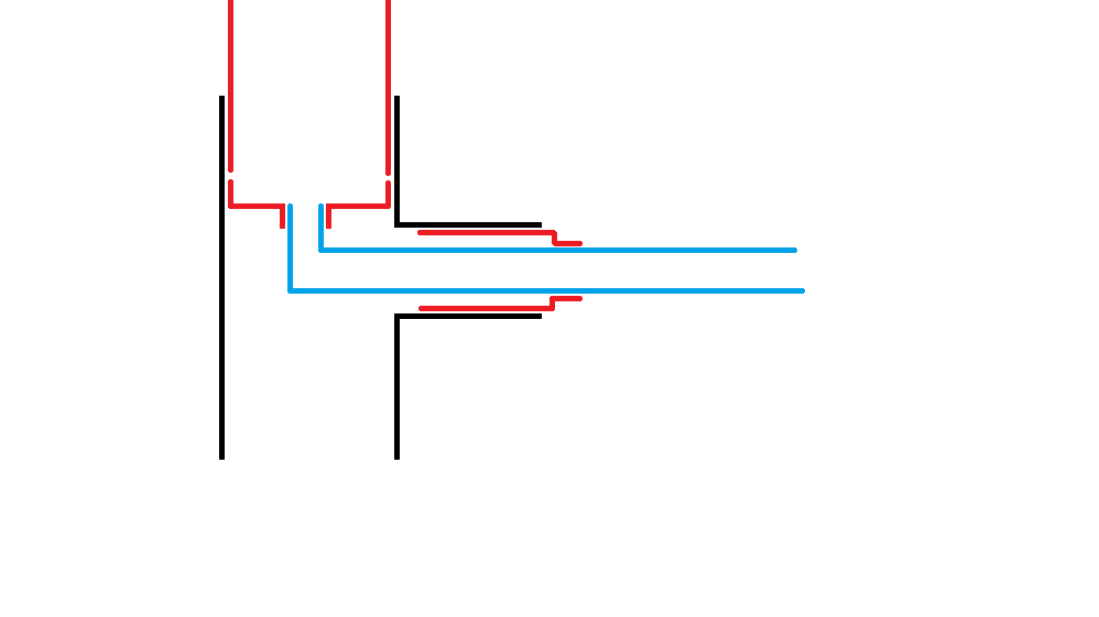

Postby Myles » Wed Mar 23, 2016 5:00 am
Benoit wrote:I'm going to use a reducing tee. I'll cap the bottom of the tee & drill into some wood as a base, if the hole is slightly snug then it should all stay standing :D
I hope you don't mind a hint. Don't do that or you will end up with a pool of distilate in the bottom of the T that will cause problems.
I assume you are using 22 mm for the vertical tube (hydrommeter reservoir). get yourself a 22 male to smaller female reducing fitting and then cut down the male part to just a few mm long.
Similar to this. This is 54 mm but the principle is the same.
Solder this to the thinner tube that you will be using for the liquid input tube and then pass it into the T and out the branch. Push this guy down into the T and then when you put in the bigger tube you can solder them all at the same time. You then just need to solder the inlet tube into the branch. I use another reducer for convenience but it is up to you.
That way there is no pool of liquid. If you then use a circular saw the same size as the bottom section of the T it cuts a trough that the T just slides into so you can glue it in place.

Thanks myles, that's certainly neater than what I was going to be doing....I will be cursed by every skilled metal worker the world over for this but my solution to prevent the pooling was going to be filling that end of the tee with solder & letting it set ::)
@YHB - Brian, how on earth did you shape those cups? Much skill & patience it's beautiful; we may have to dub you the parrot tamer, both mechanical & electrical!
