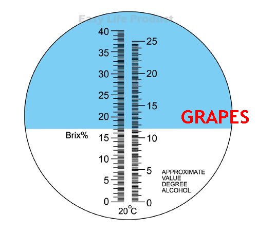

Mash uses his more than I use mine....the difference as I see it, is the top one just shows how much sugar is in say a wash.
Quote Amazon.."The refractometer itself is not included the specific gravity scale, only contains the brix scale for sugar test."

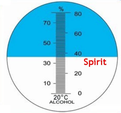

The bottom one shows the alcohol % in spirits.....
Quote.... "used to measure the density of alcohol in the solution, the measuring range is 0 to 80%"

Re: Refractometers.
For me it about making life easier. It's all about the calibration and what scale they have etched on them.
It process order then..
For setting up a ferment grapes/sugar wash/beer I like brix and %Alc (if all goes well).
The BRIX scale is the easier than SG because it is % of sugar ...so 15 brix is 15% sugar. Easy maths for recipe building.
To check the ferment is ended I USE A HYDROMETER (or my tongue - whichever is easiest)
For spirits you need just %Alc
Hope that helps.

Yup, for spirits & % alcohol, just about anything is good enough.
