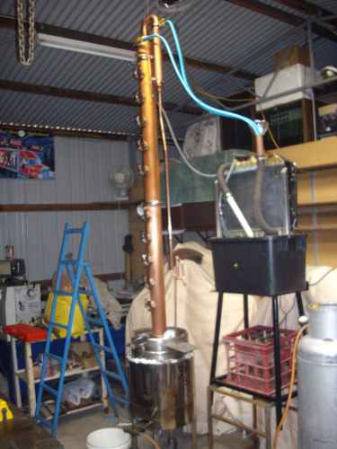

Re: Recirculating Pump? I know I need one, to save water
This is the best I can do for you.
It has a 3/4 outlet centrifugal pump. It has good flow, but bad lifting ability, therefore I had to elevate the tank on this set up so it could cope.
Ordinarily, it sits on a stand and dumps through a car radiator. A fan on the back of it pushes air through. I have used, at a guess, less than 50 liters of water for the last 12 months and its capable of back to back runs.
[quote]This is the best I can do for you./quote]
many thanks for the pic empty glass. I'm loving the car radiator! I undertand about the issues with height much better, and yes... I will buy 'more' than I think I need... I am very much in favor of slightly over engineered solutions/products that last a long time vs over-clocking cheap stuff and having it break after 2-3 uses.
