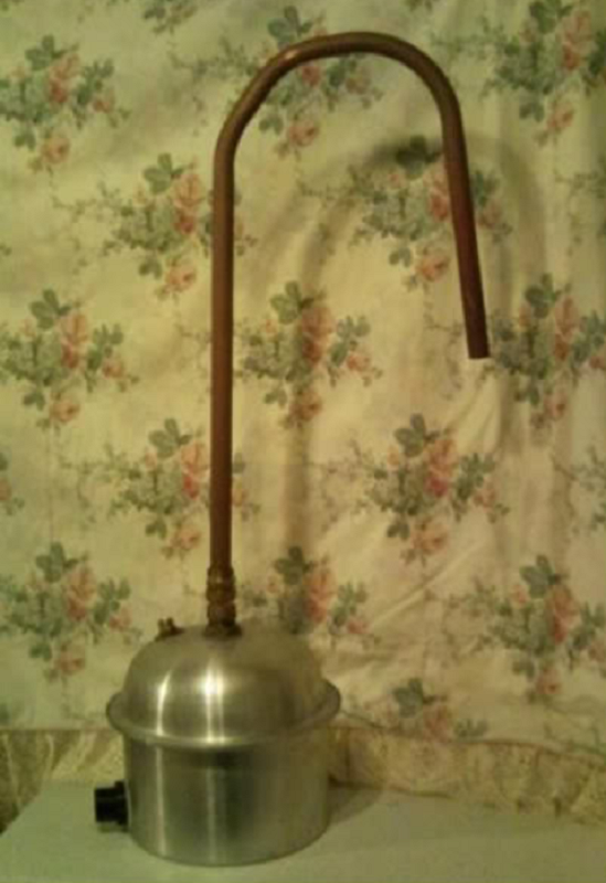

I don't run an Air Still. I will admit that right at the beginning I did try one of those double plastic bucket type stills. Not for long though.
Next I tried a Spirits Unlimited Mk5E, this is basically an electric alloy pressure cooker style pot still. OK I did modify mine to replace all the rubber washers with compression fittings and also replaced the vapour path with 22 mm copper tube.
I have made my own copper pot stills in a variety of sizes, so I can give you my own opinion.
All of these small pot stills have the same basic "flaw" that has been mentioned previously. In addition,you can NOT create drinking product with a single run. If you wish to make a neutral type product you need to do multiple runs. I stopped filtering at all and substituted a couple of extra runs with dilution and careful cuts to get the same results. A bit more labour and time intensive but it works.
For flavoured spirits they are just hard work. The "flaw" is that the transitions between the cuts are so small it just makes it tedious to do lots of small volume runs.
If you want flavoured spirits like rum and whisky, life is a lot easier if you can increase your boiler volume.
You don't need to go massive though. The smallest practical option (just my opinion) is in the 12 to 25 litre range.
If you were to use a 20 litre boiler charge at 28% you could expect to get in the order of 5.6 litres of premium quality hearts.
Cutting this down further to a 13 litre boiler with a 10 litre charge you might get 2.5 to 3 litres.
A small pot still is an alternative option, but if you can make it a bit bigger, it makes it a lot easier.
