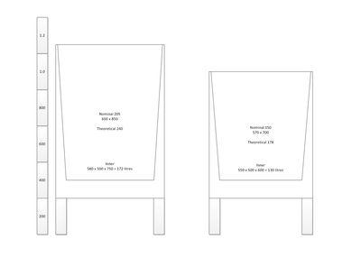

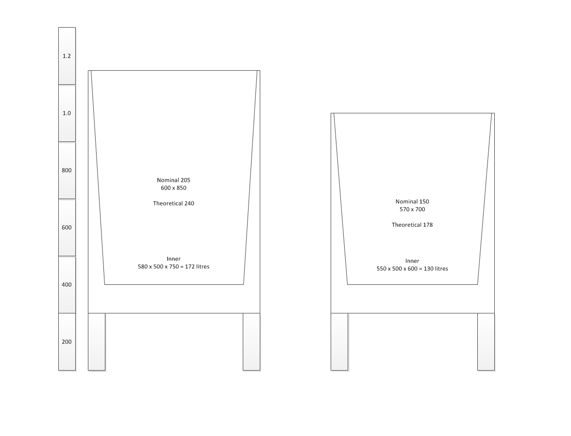

The more I look at this the more I come to the opinion that it isn't going to be as usefull as a 2 vessel system.
Yes use this as a temperature controlled mash tun, and later as a strip boiler. But ferment in a different container.
Doing that means that it does not need the volume of the fermenter and a 100 litre mash can easilly be accomodated by using a 150 litre stainless drum outer pot.
The 150 litre stainless drum is also a lot less expensive than the bigger version and is a more convenient size to work with.
Re: All grain mash/ferment
Just throwing out some ideas here regarding sizes.
Am I doing something wrong because the quoted nominal sizes for the drums don't seem to match the physical dimensions. Actual capacity seems to be more than the stated nominal capacity.
I doubt they are actually as big as these figures because the dimensions are probably the max physical dimensions and include seams etc.
205 litre drum could be much bigger than actually required making the 150 more practical.
