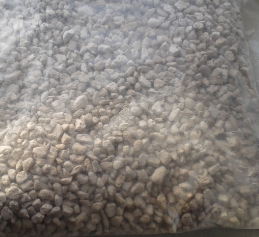

I use pummice myself.
http://www.specialistaggregates.com
Light weight aggregates section. They have scoria also. 1 bag will do many column fills. If I was at home I would just send you some for the postage.
I put mine through a 10 mm garden sieve and filled the column with the bits that passed through.

I've only used ss scubbers and lava, have been using lava for the past few years now as I prefer it. Make sure you use small thumbnail sizes, larger sizes tend to create some channeling.
