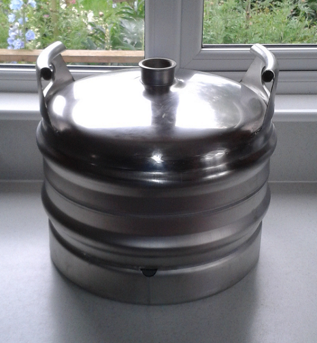

Over the weekend I started converting a 30 litre keg into a thumper. Took off part of the upper skirt. I am retaining the lower skirt as I am going to add some height adjustable legs to it.

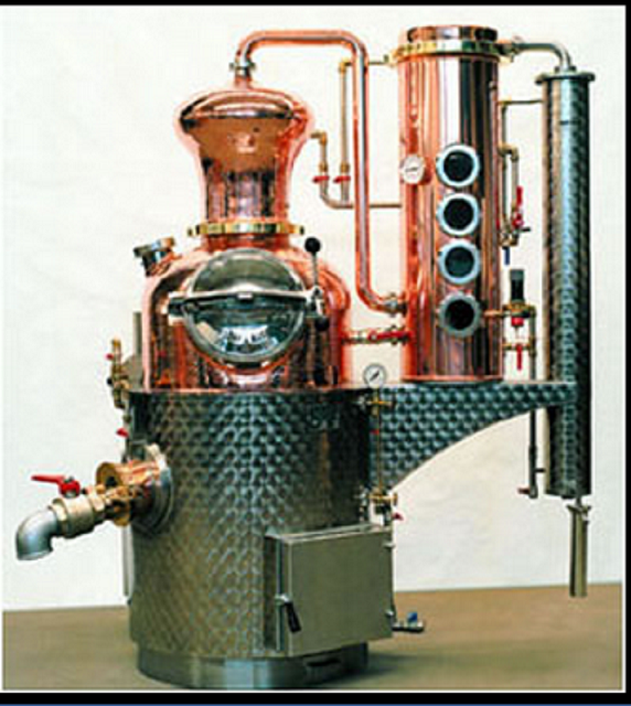

Need to fit a drain, overflow and vapour inlet. Inspired by the picture below (this thumper will have a column mounted on it) I am going to try and make all the keg connections in the lower dome, out of view.
That's quite a big thumper, what size boiler are you intending running it with?

It is a 30 litre thumper on a 100 litre boiler. Normally in pot still mode I would not bother with an overflow, but in this case it is going under a reflux column.
The idea is that it will have sufficient capacity to collect all the column bottoms and prevent the majority of these from being returned to the boiler. As these column bottoms should be mostly water, returning them to the boiler is wasteful energy wise. It just further dilutes your boiler charge.
