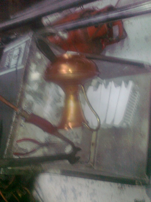

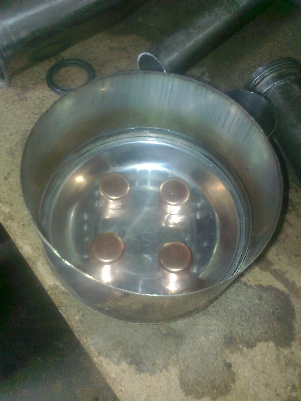

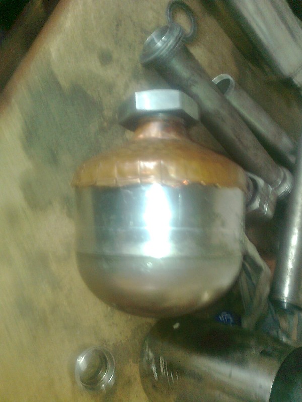

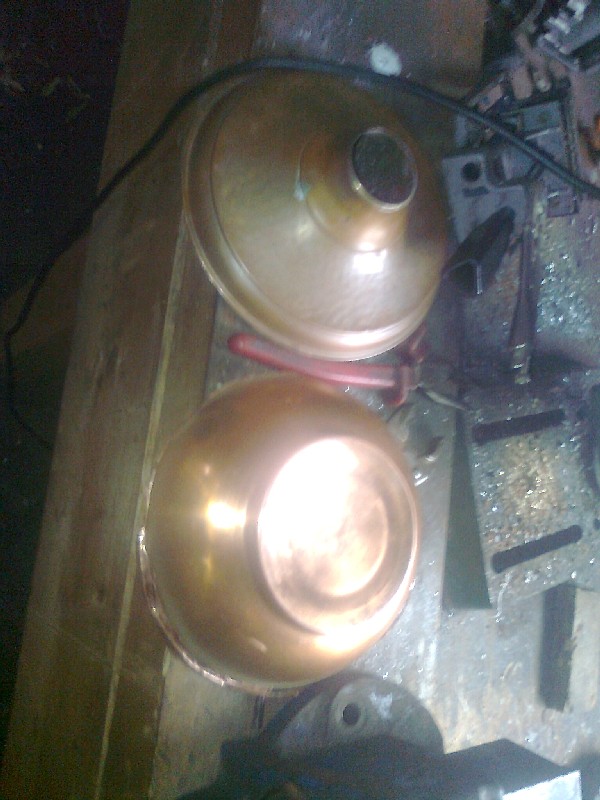

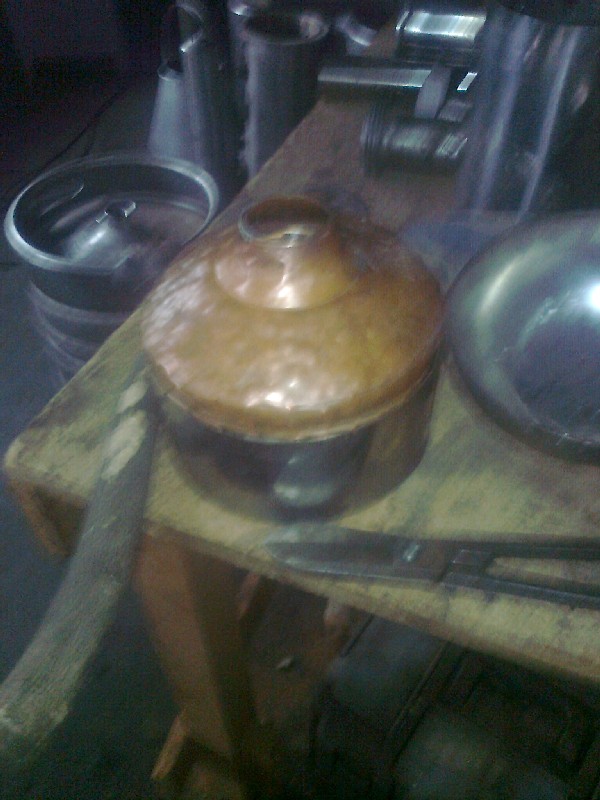

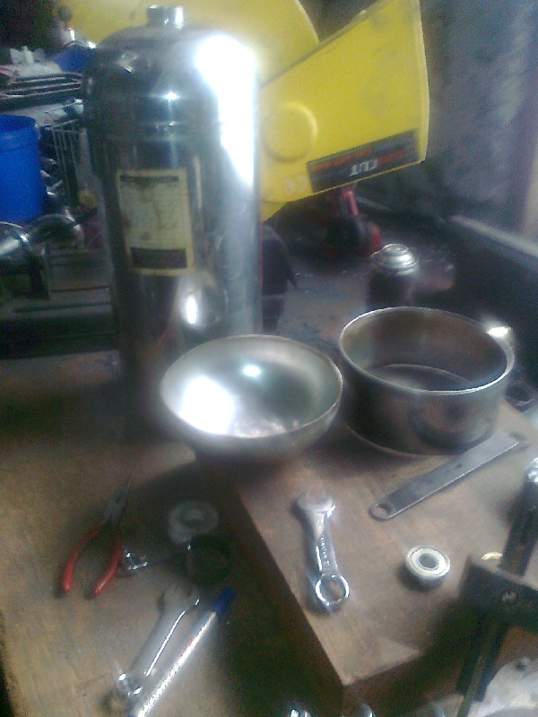

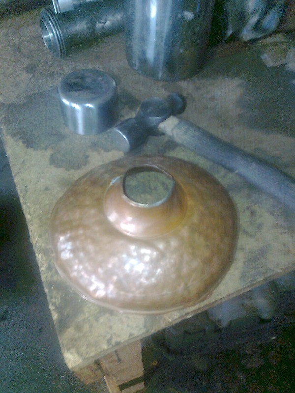

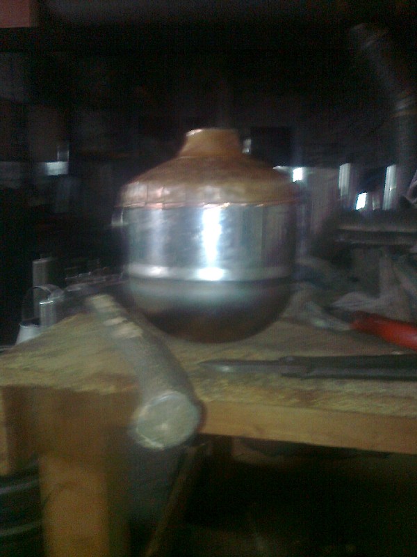

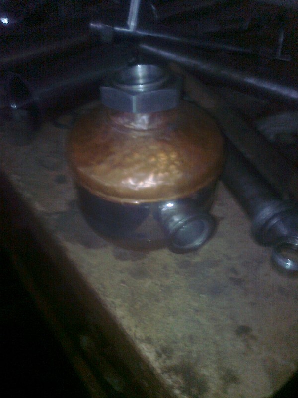

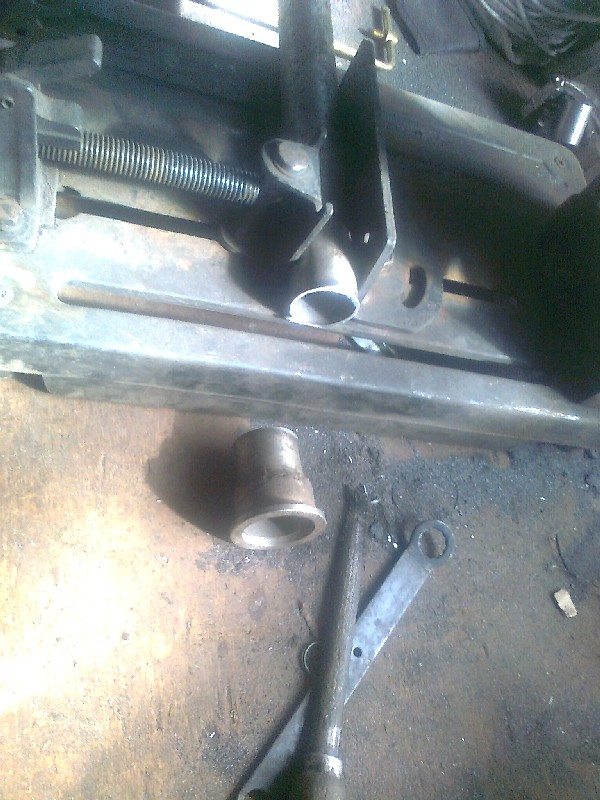

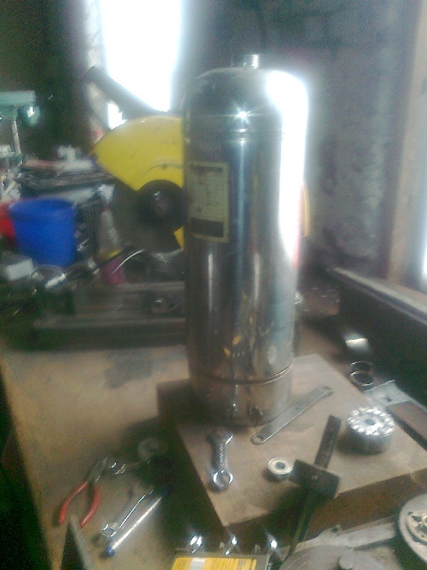

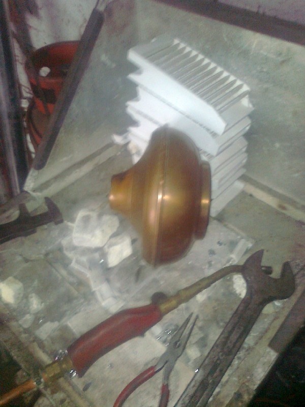

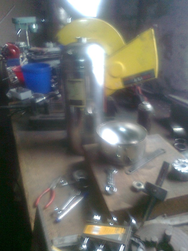

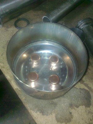

After a lot of umming and ahhing I have made a small start. I cut the bottom off a stainless fire extinguisher and the top off a copper vase/jug. used a stainless dish for a plate and began the makings of a bubbleball.
The pics should tell you better. Comments welcome. Nothing is soldered yet and the plate is not drilled for the caps either. So now is the time to tell me if I am doing something wrong. Only four caps are shown in the pic but I intend seven plus the downcomer. My local Screwfix ran out of 28mm caps. up and down comers will be 22mm.

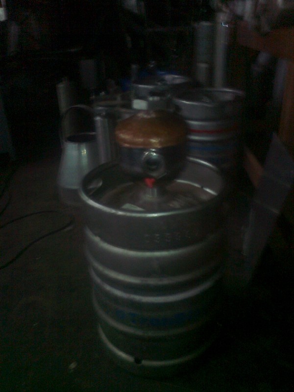

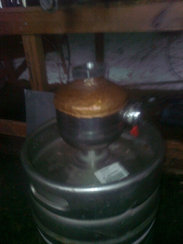

The whole thing is seven inches in dia and about eight inches high. outlet is 2" inlet will be a bit smaller as I will use the screw in spear fitting from the keg.

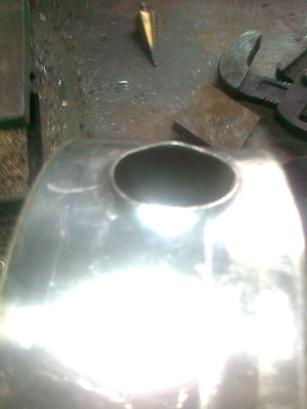

I beat the copper out from concaveish to convex. Used the bottom collar and bottom bowl of the fire extinguisher. Pulled a dimple in the side of the collar for the site glass fitting. Used inch and a half as that is what I had that looked to fit well. Used an RJT hygiene fitting for the outlet. Again just what I had lying around.
Any questions on how anything was done I will be happy to answer but don't want to bore you with a blow by blow. A picture paints a thousand words and the sequence should be self explanatory.
