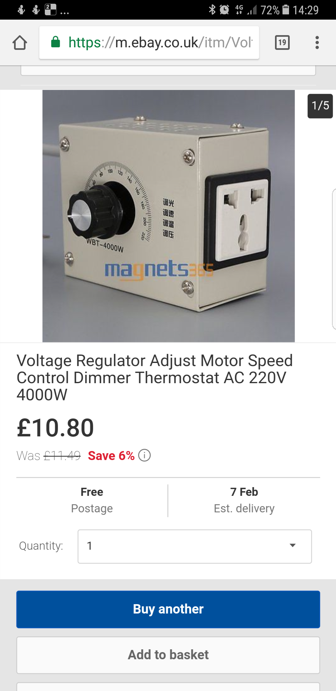

I have a 4kw controller I bought in the bay from China, works a dream. 0-240v comes with a foreign plug so you need a UK visitor plug adaptor, can but for a quid. Poundland. I use it to control my 4kw heating element in my Keggle.if u can find a link I will post it.
