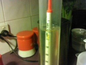

Wash is clearing nicely. SG still at .989 and holding even while cold.
Wash still has a greenish tint but is going translucent.
Taste is still slightly tart. There is no off smell to this wash at all.
Could run it now but will wait to see if it continues clearing.

Re: Googe's Kale Wash Progress/Progression "Googe's Go
Just a comparison pic to back up the thread, this is one ive had sitting for over a week, same fg as fully's
- Attachments
- 13916867544810.jpg (19.68 KiB) Viewed 3560 times
Obviously the Kale has serious nutrients for making the yeast happy and producing such a nice clear wash.
