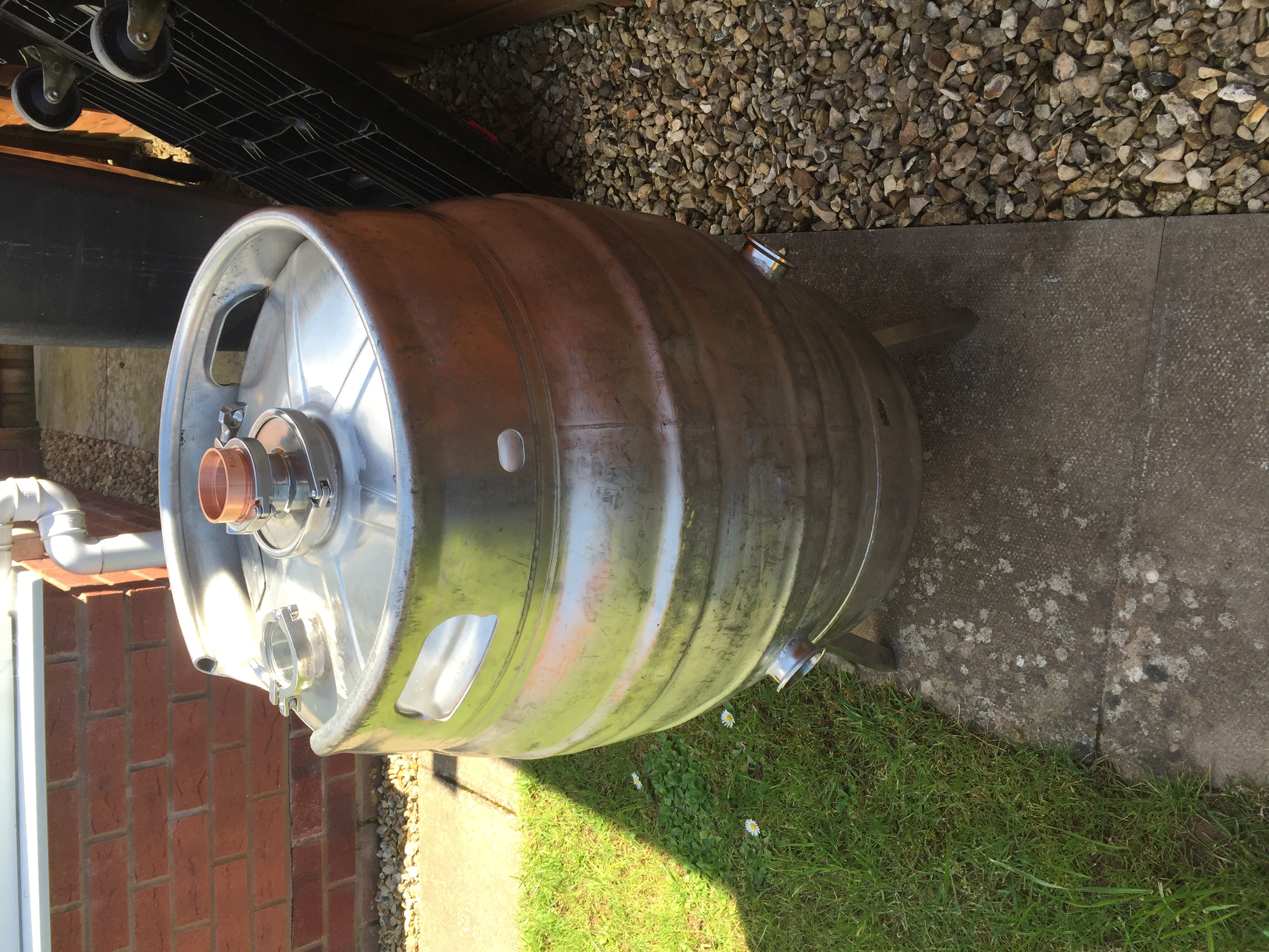

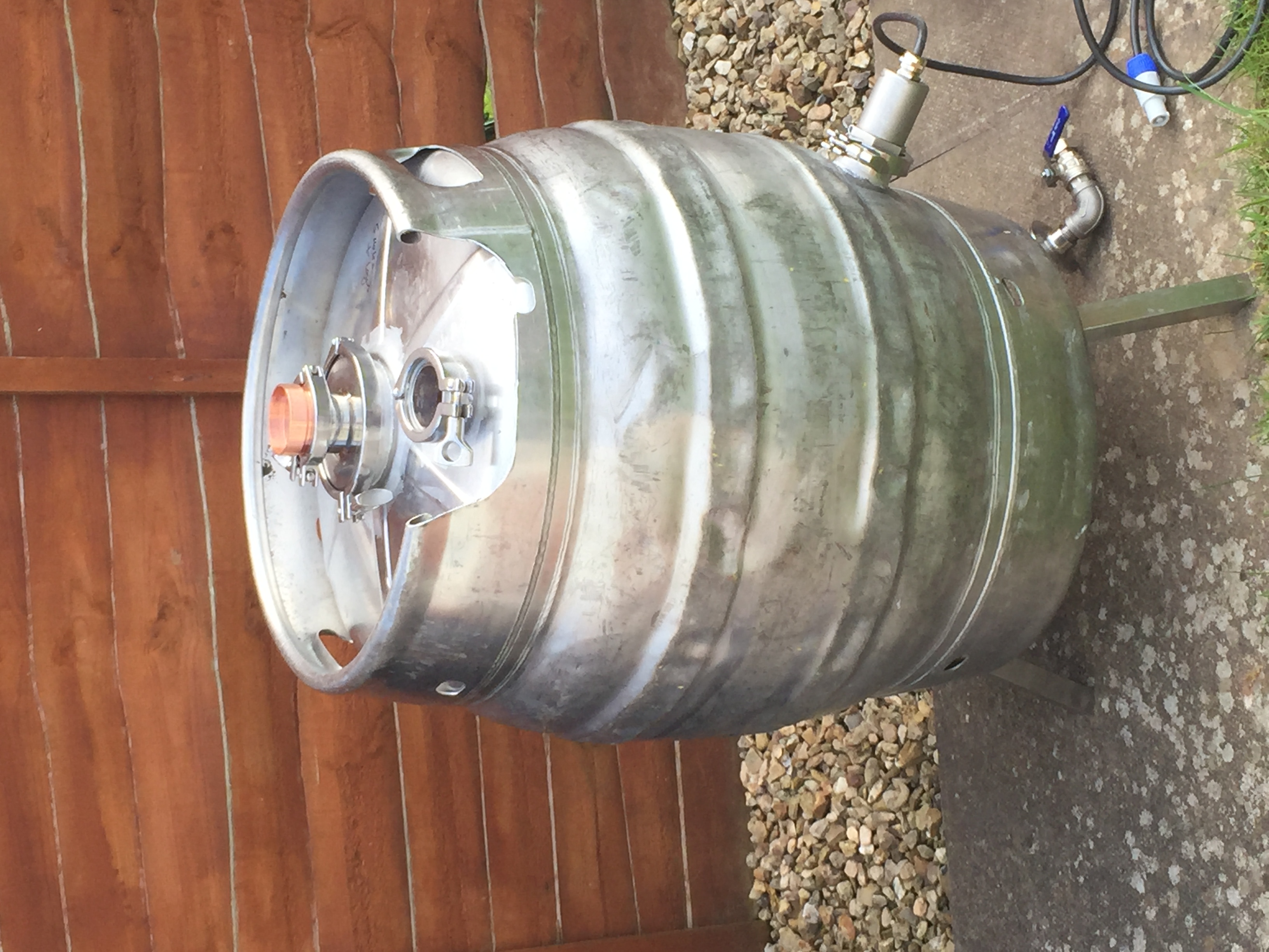

Postby Devon » Sat Apr 23, 2016 10:39 pm
I've got my final piece to my set up completed this weekend, 100l boiler made from 100litlre keg. I've had legs added so that it allows a bottom drain. Two elements in the side totalling 5kw and a 2" sight glass / fill port and a 4" connection for the Column to allow for future expansion but for now ok just going to run an adapter to fit my 2" boka

Postby chill » Sun Apr 24, 2016 12:17 am
I am envious!

Postby Devon » Sun Apr 24, 2016 9:13 pm
Hit a slight issue, with the column the whole unit is pretty high and I've just moved house so don't need the neighbours getting suspicious, going to have to run it at night to evade nosy eyes

Postby Capt-Cudellez » Sun Apr 24, 2016 10:12 pm
Very nice boiler - for the capacity and watts you have is there a reason you didn't go for a 3" column?
With a 2" boka you are going to be limited to 1500-2000w on the spirit run and have longer running times.

Postby Devon » Mon Apr 25, 2016 10:08 am
I'm using these particular elements because I also use them on my brewery so I can undo the triclamp and swap them over. The boiler is built to take up to 4" column but I'm currently collecting up components to make a 4" flute column for later.
