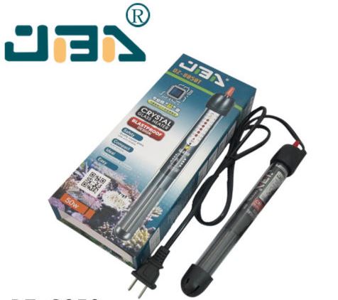

Just bought a cheapo heater from ebay - £6.95 including postage from the UK seller.
Not expecting too much but hoping at least for a UK plug.

That looks rather like some of the units that I have owned/do own.
If it doesn't have a UK plug,it will come with an adapter, they always do.
I test all mine against a thermometer,then wrap a short flag of silver "Duck Tape" around the cable near the plug, and write on that with a Sharpie the actual performance, i.e. 30%°C is really 25%°C. Or "reads 5% low".
HTH
HTH
