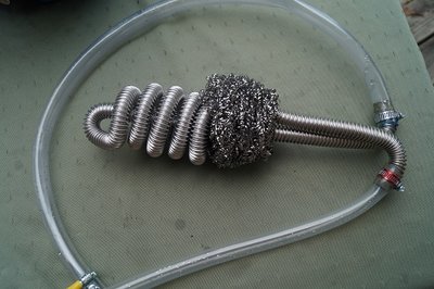

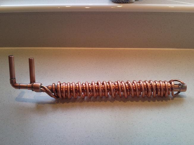

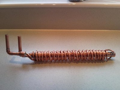

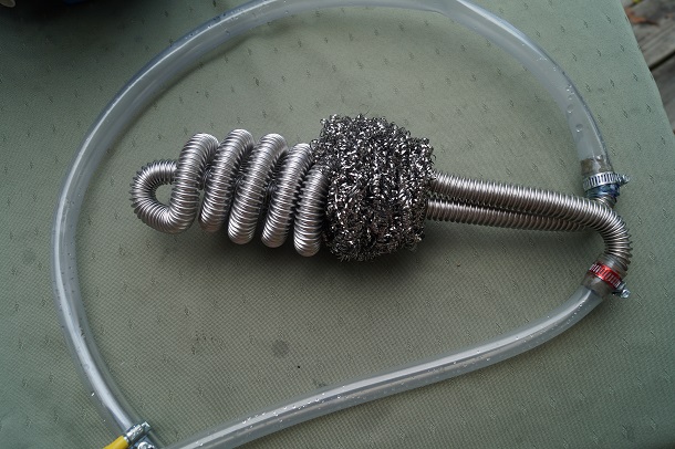

You can build double coil and coldfinger condensers to fit into 2" tube if you really must. You do not need to for this particular application, but here is an example.
Have you thought of using convoluted stainless hose instead. There is a user called dad, that does just that.
http://www.stilldragon.org/discussion/366/vapor-path-flow-and-the-effects-of-product-condenser#latest
