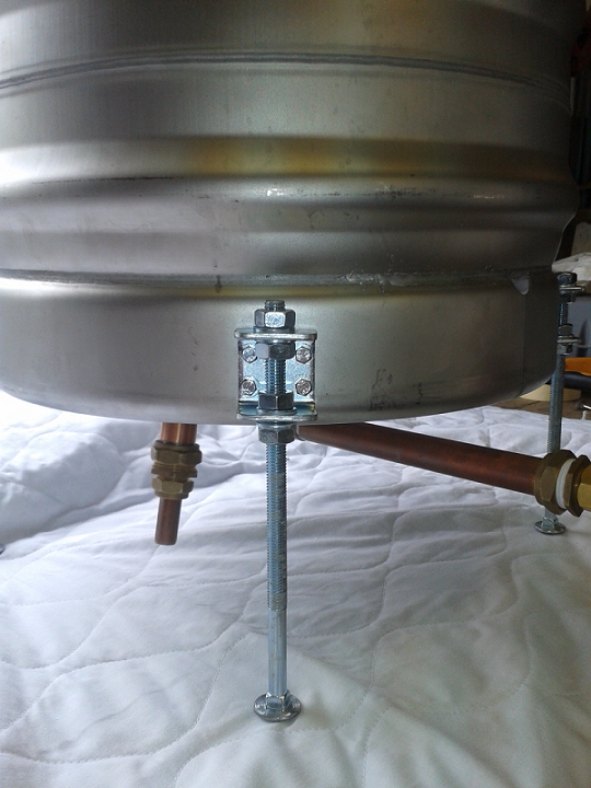

The copper washers can be anealed to make them soft which you can't do with stainless ones. I have used that method with drain connectors also.
I used 5 mm stainless bolts to fit the brackets to the keg. I was surprised by how easy it was to snap the bolts with a socket wrench, so watch your torque.
