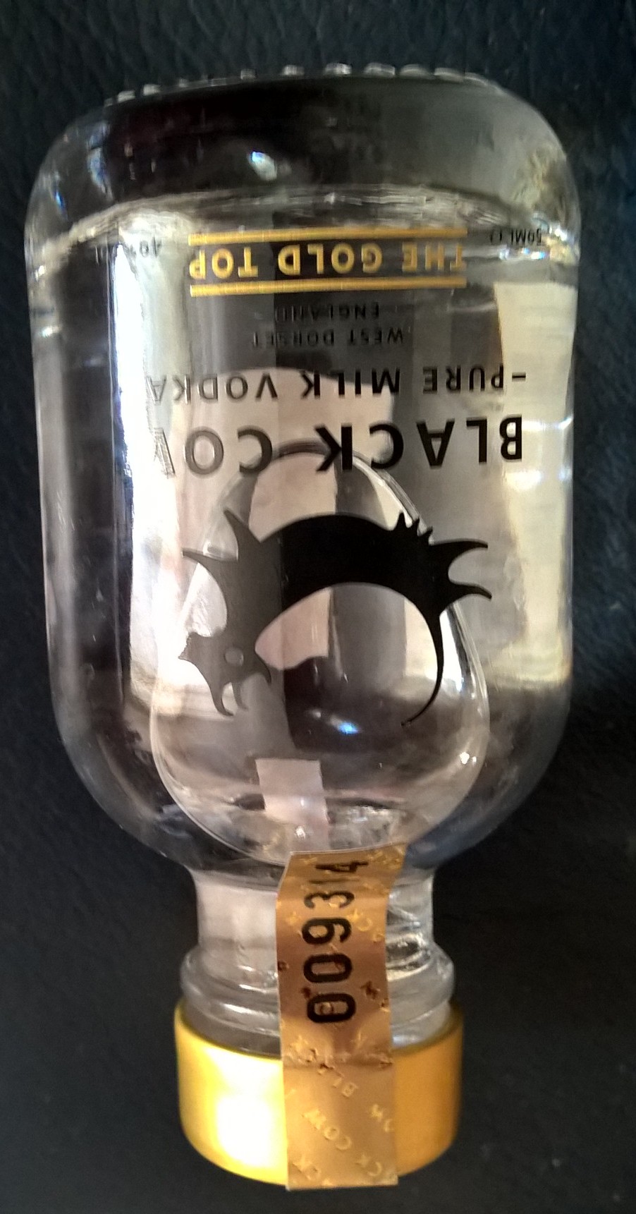

Just picked up this little bottle from my local deli.
Made from milk in Dorset.
Cost £5.90 for this 50ml bottle so not particularly cheap.
Anyone come across the idea of milk vodka before?
