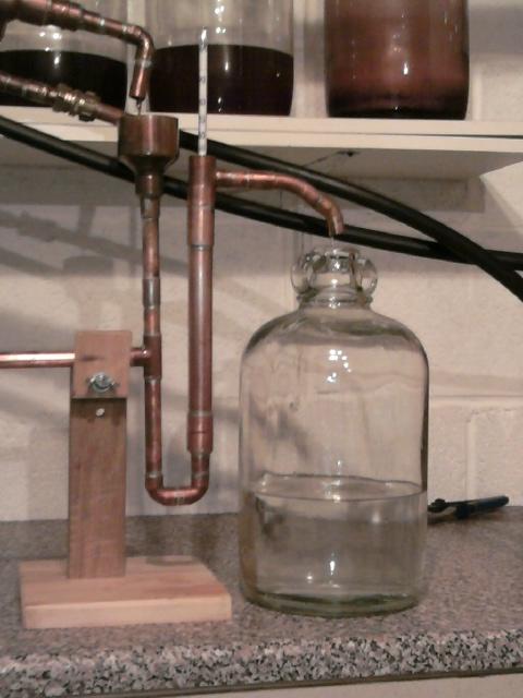

This is one of my Parrots at work...(click on pic for full size view)
...this allows me to collect distillate from separate Stripping Runs into the same collection vessel, in this case a DJ, because I can see the ABV as it drops, making Airstill Stripping runs less boring and more predictable ;)

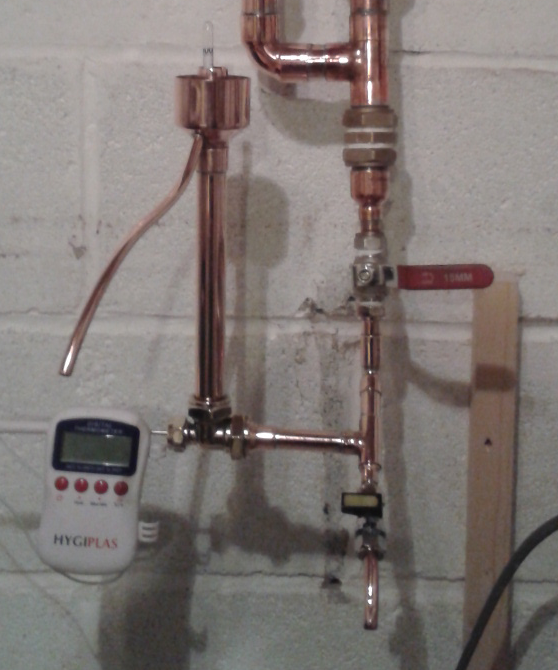

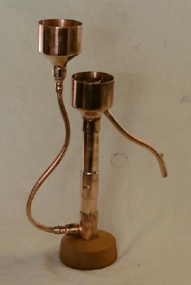

Postby Myles » Fri Oct 25, 2013 3:16 pm
And don't forget a parrot is also an opportunity to show off some functional art. Whatever style you go for:
Low volume ones generally need some sort of stand so that you can adjust the reservoir to be vertical.
Wider bodied ones don't need this and can be free standing
My latest is used in combination with a thermometer higher up the vapour path so it can have a small by-pass valve so the heads don't get into the parrot. I can also measure product temperature easily for accuracy.
Lots of ways to build them.
