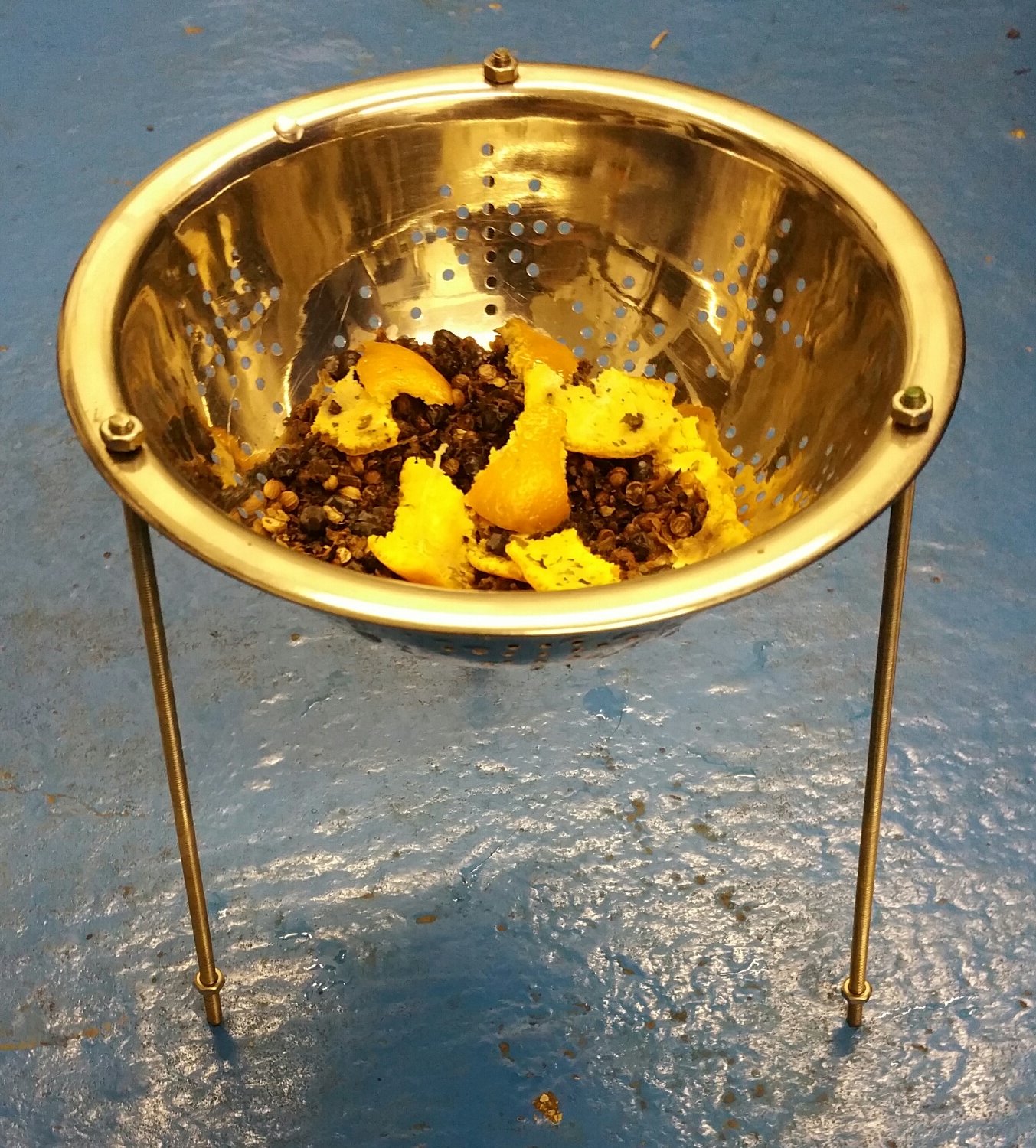

The sputnik has landed.
This is the very first run. I am sure we can develop this recipe, but it is close enough as a first go. I was v happy with product.
Ingredients
• 12 g juniper berries.
• 6 g coriander seeds
• HALF skin of one tangerine. (NEXT time whole skin maybe)
• 1g Angelica
• 1 L 40% neutral (ready to drink)
• 1 L water
Method
Lightly crush the seeds.
Fill still with water & alcohol
Fit basket, then fill with crushed botanicals. Doesn't matter if some dust falls through.
Run Air still for 2.5 hours (or until 0% or until 750ml is reached)
Drink immediately to celebrate !
Notes
Yield. You should get 1 x 75c bottle at 40%
The basket is a small colander/sieve with the handle removed - it is much easier to clean than mesh. The legs are 385mm x 4mm SS threaded bar.
The extra litre of water is to give the still something to work with, stop it boiling dry and give plenty of time for the steaming.
PS The sputnik joke won't work until you make one and then turn it over.
The total cost is about a fiver. If you want any photo's or links shout up.
Re: Airstill gin basket
Postby Easydrinker » Sun Dec 27, 2015 11:21 pm
A neat and low cost solution.
Well done.
Postby chill » Mon Dec 28, 2015 6:35 am
Thanks! That looks ideal and achievable, even for me!
