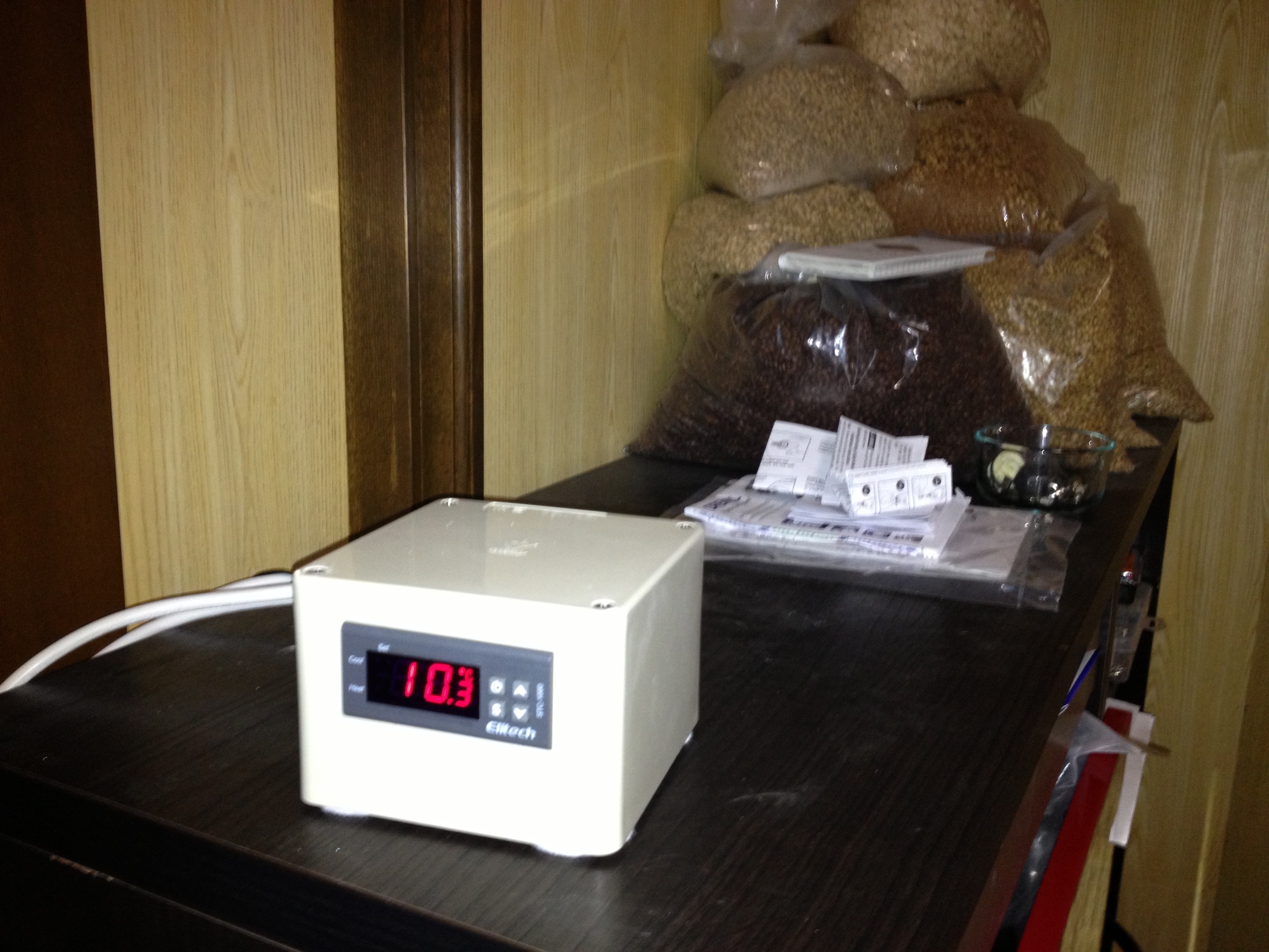

I have had my controller working for a few months now, all the ferments have been so clean and complete and there is a noticeable improvement in my product.
A TPW takes 11 days - not 10 - not 12 but 11 days and with the bakers yeast I use will ferment dry 5 kilo's of sugar to 0.990.
I screwed up and by mistake put 6 kilos of sugar in a couple of All-Bran and Weetabix washes, these were still dramaless and again with the final SG being 0.990. Once more there were no off tastes.
I put these successes down to the constant temperature that the yeast is provided with by the controllers.

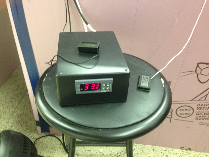

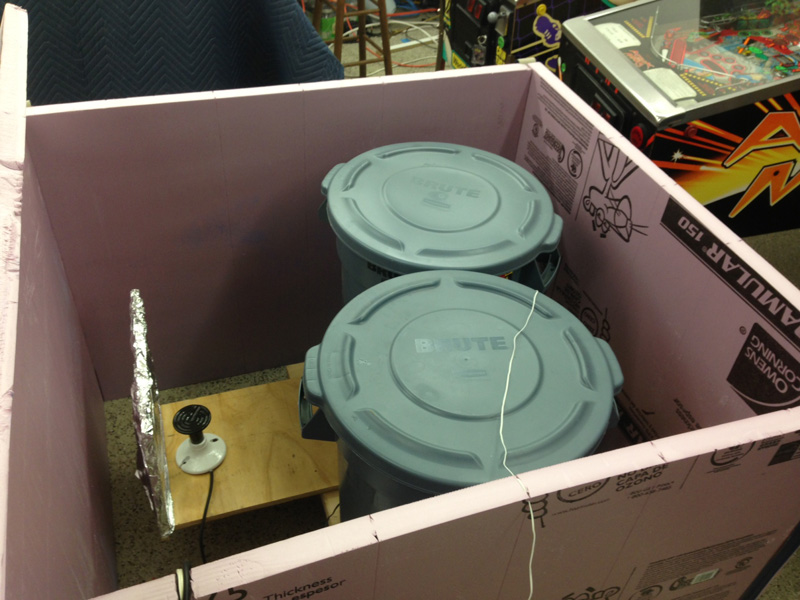

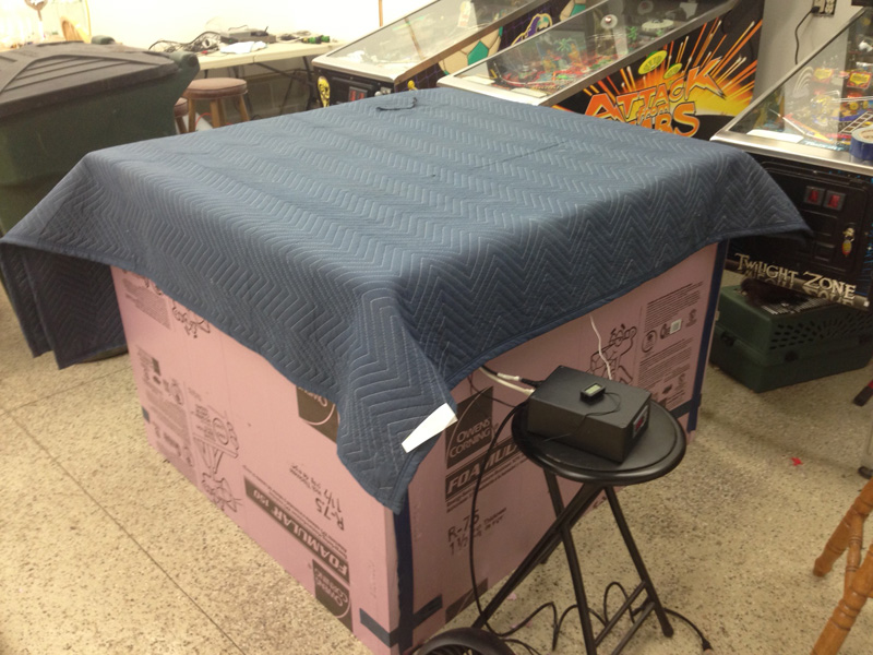

Good Thread!
The weather in my part of the world has been anything but stable. Last week we had 3 days of nice weather, just shy of 25c. the next 3 days brought an ice storm and 4 inches of snow.
Similar to aidanmacs use of foam board, this is my solution until I get around to finishing a proper fermenting room.
I used a table saw to rip 4 - 4' x 3' and 1 4' x 4' section for the lid. Everything is duct taped together for easy tear down and storage. There is enough room for 4 - 20 gallon Rubbermaid brutes. Heat is provided by a ceramic heating bulb (aka: lizard lamp) and it has no problem keeping all 4 fermenters at temp.
Its nothing ground breaking but hopefully someone can get some ideas that might help out.
