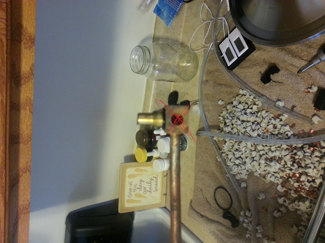

I just wish I had a picture of the coil inside the column to compare mine with

The fact that my wash is coming out of the water outlet is what has me worried..if you look at the pictures I posted on the bottom of the copper coil you can see the nozzle where the water comes out and an additional hole. Idk if that hole is supposed to be there or not.

I finally just looked at mine and there is only one hole on your second picture for the outflow. On yours i noticed one going back out into the column inside part. That not right at all. Sorry for your troubles but hope you get it all straighten out soon. Not bad peace of hardware to have at all.

Thanks for threhelp mike! A few days ago I called the shop where I bought it from and the owner sent me a return label so he can see for himself. He check it out and said there was something definitely wrong and over nighted a brand new column. Adventures in home brewing in Michigan really has top notch cust service!
