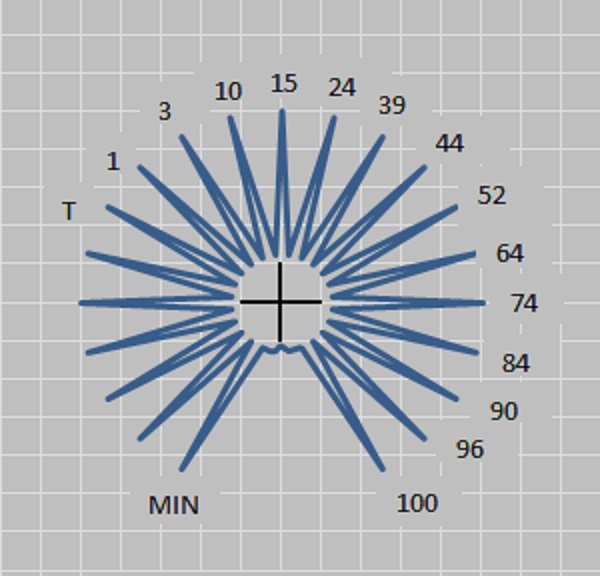

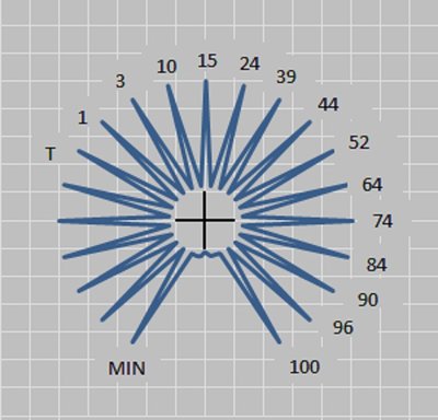

Burst fired and SSR do the same thing but by slightly different methods. I use both and they both give variable power outputs over a rangeof values. It is usefull to check what the variation is, even calibrate them.
To do a propper job you need to measure both current output and voltage output as on most controllers these BOTH vary constantly.
This was a PSR 40 connected to a 6 kW element in %age of max power.
