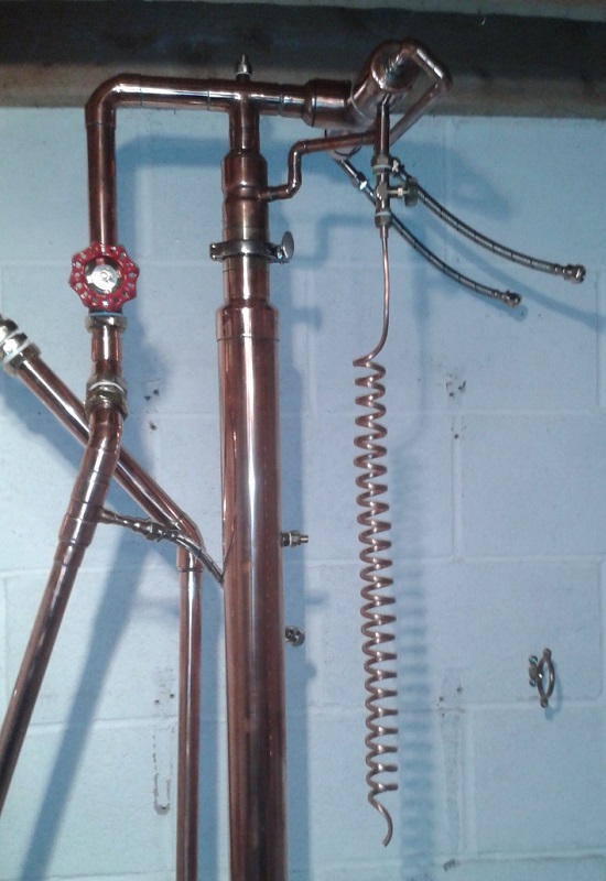

Treat the 2/3 section as your main column from the design point of view with the short section as an add in for when you want neutral. I wouldn't bother fitting any temp sensors in the short section.
In the longer section it is up to you where you place sensors but I find it convenient to have 1 main sensor (somewhere) in the head itself, and a supplementary sensor about 1/3 of the column length down from the head. Just for a bit of advanced warning of temp changes.
I use a 2 channel temp sensor that reads out both temperatures at the same time (or the differential between them) which I find convenient.
Where you put the sensor in the head is just a matter of convenience, but it helps if it is above the reflux return, so that it is only exposed to product vapour.
