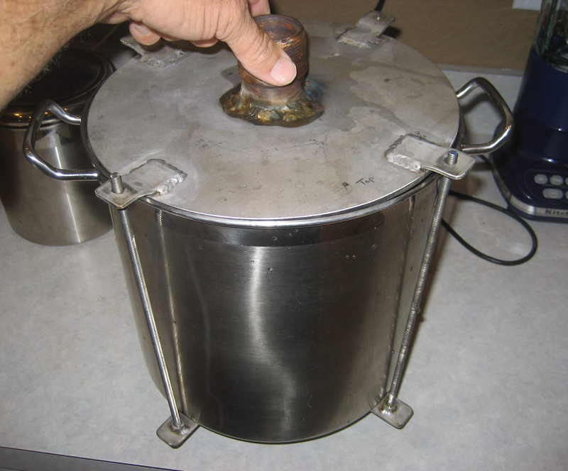

Take a look here viewtopic.php?f=15&t=2658 my still,I think the pics show the lid fixing,basic carpentry to a boiler fitted with handles.

This system was shown a few years ago. Functional but I am sure it would work OK.
