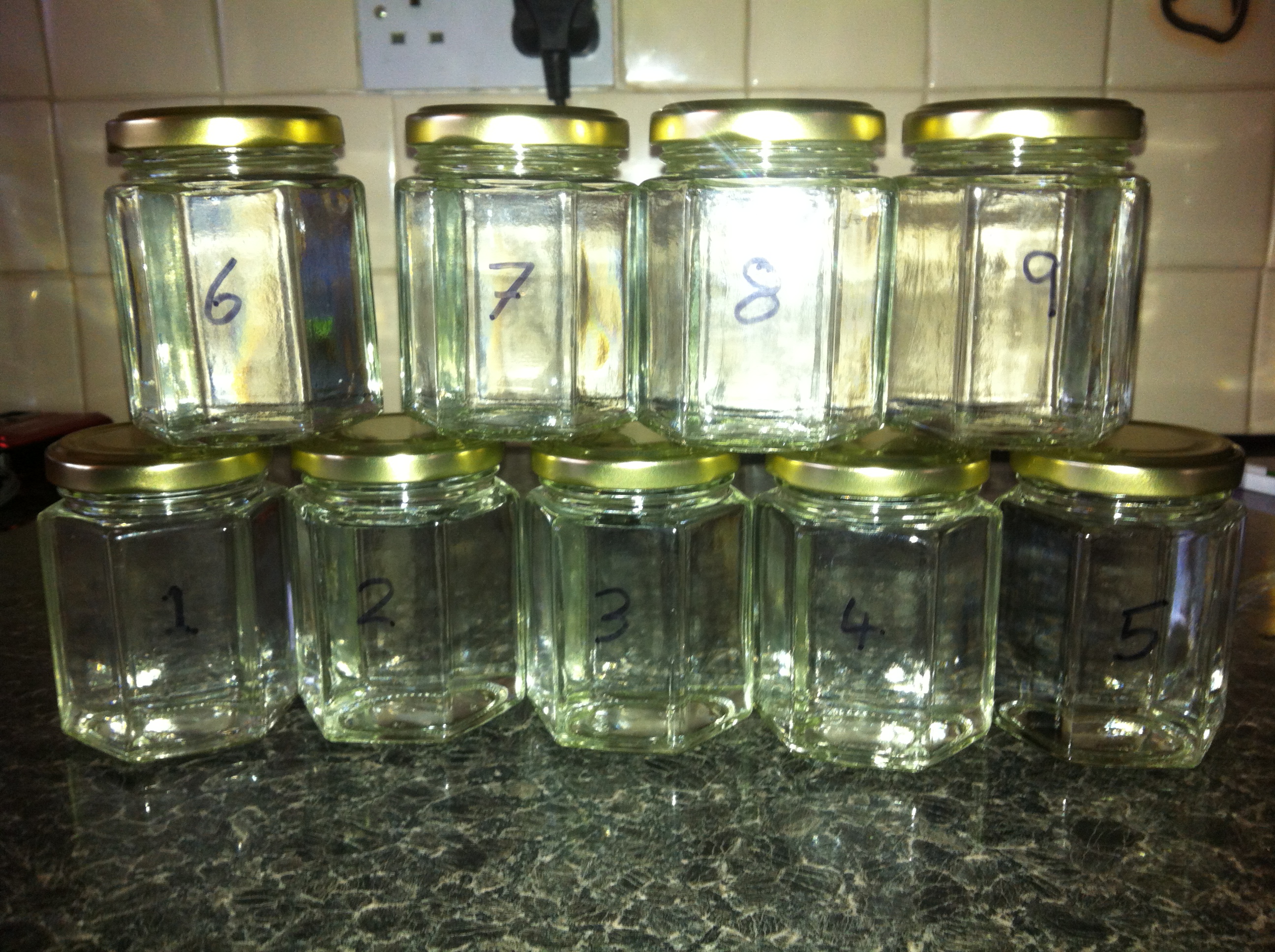

Right, so I've done a 25 Litre sugar wash which came out at about 14%
I have run it through the T500
First 100mls fores tipped
Now I expected to get about 3 litres of 94ish% so I have collected 300mls as heads
I bought 15 of these 8oz/190mls jam jars and started collecting in them numbered 1-15 which is about the rest of the 3 litres it produced
Tomorrow I will for the first time attempt "cutting" and see what all the fuss is about, though as far as scent goes they all smell the same so that just leaves a difference in taste.
Will let you know how I faired

Re: To cut or not to cut that is the question??
Superslim007 wrote: though as far as scent goes they all smell the same so that just leaves a difference in taste.
At high proof, all you'll smell is alcohol. Take a tablespoon from a jar and put it in a glass with 2 spoons of water. Swirl it, then give it a smell.
Try one from the beginning, and one from the middle. It take a while to get your nose in.
Capt-Cudellez wrote:Superslim007 wrote: though as far as scent goes they all smell the same so that just leaves a difference in taste.
Will do
