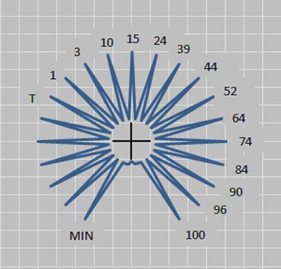

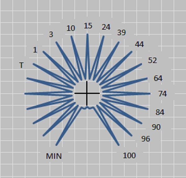

I may be a bit late to contribute to this but I have built a couple of controllers for up to 6kW.
Firstly the output voltage needs to be measured between the two element legs and the current in series with one of the element legs. Probably obvious but the first time I did it I got it wrong and tried to measure the voltage between element and earth - oops!!
Regarding lag. In my own controller there are actually two controllers. One is a PWM 40 Amp component built kit, it is one of pintoshines from Artisan Distiller. This one shows the threshold voltage. You need to turn the control up to get the device to switch on, but you can then back it off again and it remains on below the threshold voltage. I calibrated this on a 3kW element.
The other is an off the shelf Burst Modulated controller from United Automation. There is no observable threshold. You turn it up and it switches on, back it off and it switches off at the same point.
The other I built was a United Automation PSR 40 PWM again, it is just the same. No observable threshold, just on and off at the same point. I suspect these encapsulated controllers have additional circuits to eliminate the threshold seen on my component built kit.
Just for info this is the calibrated dial of the PSR40 on a 6kW load. Percentage of power to indicate the linearity of the device.
Re: Yet another power comtroller
On this particular design the volts is taken from between neutral and the live input to the controller. The amps are sensed inductively by a small current transformer slipped over the output live from the controller. The hows and whys are above somewhere.
I have heard that some triac circuits suffer from switching hysteresis causing lag. As you say these controllers seem better designed. They are triac based on the inside and prolly controlled by a resistance capacitance timing circuit. This control circuit is one reason why they are non linear.
Thank you for the dial. I see that exactly a third of the dial has no effect. I suggest replacing the pot with one two thirds of the value. This will eliminate the dead zone at the beginning and increase resolution as the remaining two thirds are spread across the full adjustment of the new pot.
You will always get a dead zone. You need a certain current to trigger fhe triac. How much depends on the component in use but there is always a trigger current to open the gate.
It's inherent in the design of the circuit. Typicaly there is a diac controlling a triac.
Both components have their own trigger voltage and these combine to create fhe dead zone. In reality it does not matter. You have ample power control in the remainder of the range.
I suppose an advantage of the component built circuit is the ability to back off the current. On my pintocontroller, once it is switched on and conducting, I can back it off to about 700 watts. Try that on a PSR 20 or 40!!
No I don't think so, not always. If you change the value of the pot it will be starting at the point it turns on with your current pot.
As you turn the power up you are turning the resistance down. Using a smaller value pot you can start at the resistance that triggers the circuit instead of waiting to get it down that low. There is no difference between your current pot turned down to the trigger point and a new pot that starts at that same value. The controller still does need that min power to turn on but you start right there and don't waste pot track getting to it.
You just lose the dead zone and increase resolution. All good but if you are happy with what you have stick with it.
I think I am misunderstanding something on a different point.
After the trigger point your dial indicates 1% power. From 6kw this would seem to be 60w.
Yet you state you cannot turn it down to 700w. I find that confusing. Is the percentage range spread over the available wattage that starts somewhere above 700w?
My controllers are calibrated for both voltage and current on the output from the controller. The encapsulated version (PSR40) used for the dial shown did actually have a usable range of 1% up to 100% power.
This was unusual in my view as some of the other encapsulated versions I have seen do not do this.
On my component built circuit (with a 3kW element) at switch on it is already conducting at over 1kW but once conducting I can reduce it to about 300 watts at which point it switches off.
Most of these circuits use the pot to control a Diac and the current flowing through the Diac in turn switches on a Triac. What is actually important is the minimum current flow in the triggering circuit.
When the Triac switches on the output current jumps from zero to about 1/3 of full current. On most once triggered you can reduce that current but usually not all the way to zero. I suppose it all depends on the type of triggering circuit used.
That is interesting. Sounds as though you got lucky with that one.
It will of course depend partly on the size of load you put on. 1% of 6kw is bigger than 1% of 3kw.
The dodge of using a smaller pot to optimise control assumes you know the largest load you will use and size to that. If you then switch to a smaller load there will still be a bit of dead wasted track on the pot. Just not so much.
If you go the other way and switch to a larger load than the one you used to size the pot you will be straight in at a higher power than you could have turned down if there was pot track there to do so. Which might be bad. Certainly less than ideal to the purist mind even if it is still low enough in practice.
I'll let you know how mine works after I play with some tapering resistors.
