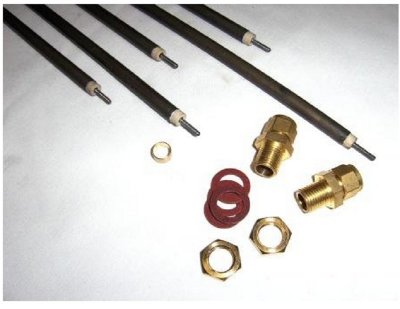

One of the problems for UK builders is that our readily available elements are so big. You can get 2" or 2.25" easily enough but try fitting them to a 50 litre keg.
If you can get a keg welded it is not too bad, but if you wish to do it yourself that means a compression fit flange. Even a 2" Essex is a bit difficult and the next size down element is 1.75" BSP. I still have not found a non-weld flange option in that size.
However, you can fit a 1.5" essex flange quite easily. Add a nipple and a cap and you have the starting point for a DIY element option.
You can get 8 mm bendable element rods easily enough. Add in a pair of 8 mm compression fittings soldered into a 1.5" BSP end cap and you have the basis of a reuseable element system.
When your element burns out you just need to bend a new rod and get 2 of 8 mm olives and you are back in business.
OK the upfront expense is a bit high. About £70 for the keg flange plus all the bits to make an element but compare that to the options.
You can fit a 2" BSP flange but have you seen the price of a 2" element?
You can get 1.75" BSP elements but I have not yet managed to find a 1.75" compression flange. Any of you had any luck?
I even thought about using towel rail elements on a small 30 litre keg but discounted it due to the price.
Any other thoughts on the issue?

Runningman, I know you can bring in 1" elements, but this has always been about trying to find a no-weld option with easily sourced local parts.
Perhaps this diagram will help to explain 1 potential option.
Essex flanges are a relatively easy self fit option. I don't know yet if they do one with a 1.75" BSP internal thread. (That thread only appears to be used on 16" 3 kW elements for uni heat and combi boilers)
However a 1.5" BSP essex flange is a standard item and readily available. As are brass 1.5" BSP nipples and end caps.
The element rods themselves are available in a wide range of power and length from here:
http://www.expresscateringspares.co.uk/3000-Watt-Bendable-Heating-Element-762mm-Long-30-Inches/6770.htm
EDIT: Sorry forgot to insert this:
These are bendable 8 mm rods for which an 8 mm compression fitting could be used to provide a liquid tight seal. Now if you were to drill a 1.5" BSP end cap and fit and solder in place two 8 mm compression fittings you would have a reuseable element boss.
When the element burns out just undo the two 8 mm compression nuts, push the element through and cut off the rod ends and olives. Bend a new rod, insert with 2 new compression olives and you are good to go. Doing it yourself gives you a range of element lengths and power options. The company recommends the use of a mini bending tool to bend the element rods. Readily available for 6/8/10 mm tube.
For comparison here is a source for the 1.75" and industrial 2" elements. Both of these would fit into a welded on flange but be prepared - the 2" elements are expensive.
http://www.milkingmachines.co.uk/uk2shop-11.htm
You can fit the cheaper 2.25" elements to a 100 litre keg, but they are too big for the smaller kegs.

Sorry I should have mentioned this point so thanks for the reminder.
There are THREE different types of washers available for Essex Flanges.
WHITE RUBBER these are usually what comes in the box suitable for water to 60 degrees C
BLACK EPDM suitable up to 90 degrees C
and "SX" washers. These are a cork composite. Suitable to 120 degrees C and approved for Kerosene, Ethylene glycol, Aviation Fuel and Anti Freeze.
Should be more than adequate for use in the boiler, and these are the ones that I use on my 100 litre keg.
